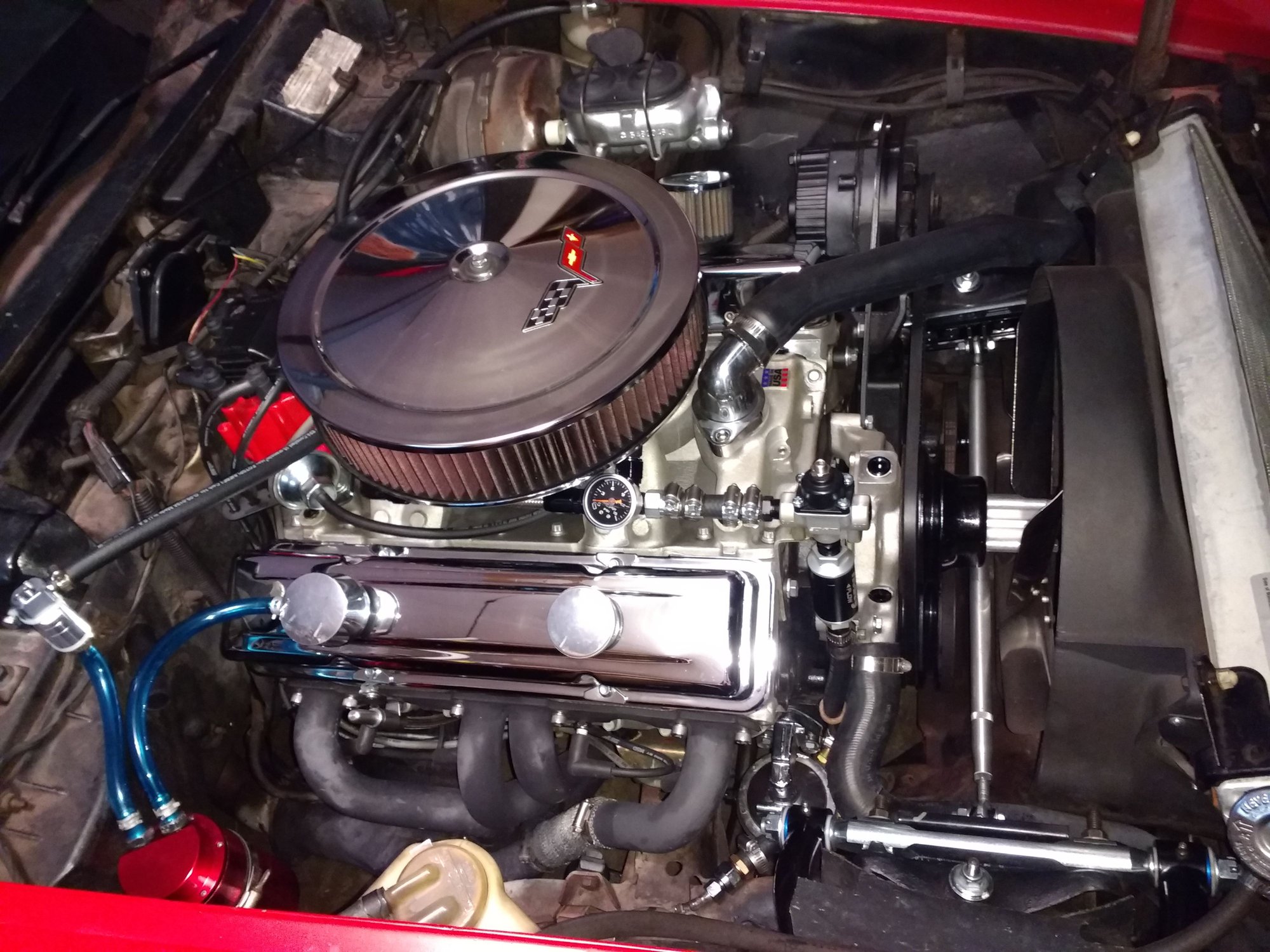

I'm using a Summit 239433 with about 1" of drop base. I have more than 1/2" of hood clearance at the front if the air cleaner top. It is mounted on a Quick Fuel HS780 with electric choke.
You can see in the photo it works with my MSD HEI, just barely. No cutting involved.
Steve

[QUOTE=Silvertone;1593986199]I'm using a Summit 239433 with about 1" of drop base. I have more than 1/2" of hood clearance at the front if the air cleaner top. It is mounted on a Quick Fuel HS780 with electric choke.
Here is the link to Summit https://www.summitracing.com/parts/sum-239433.
This is a 14"x3" filter and the car is a '77.
