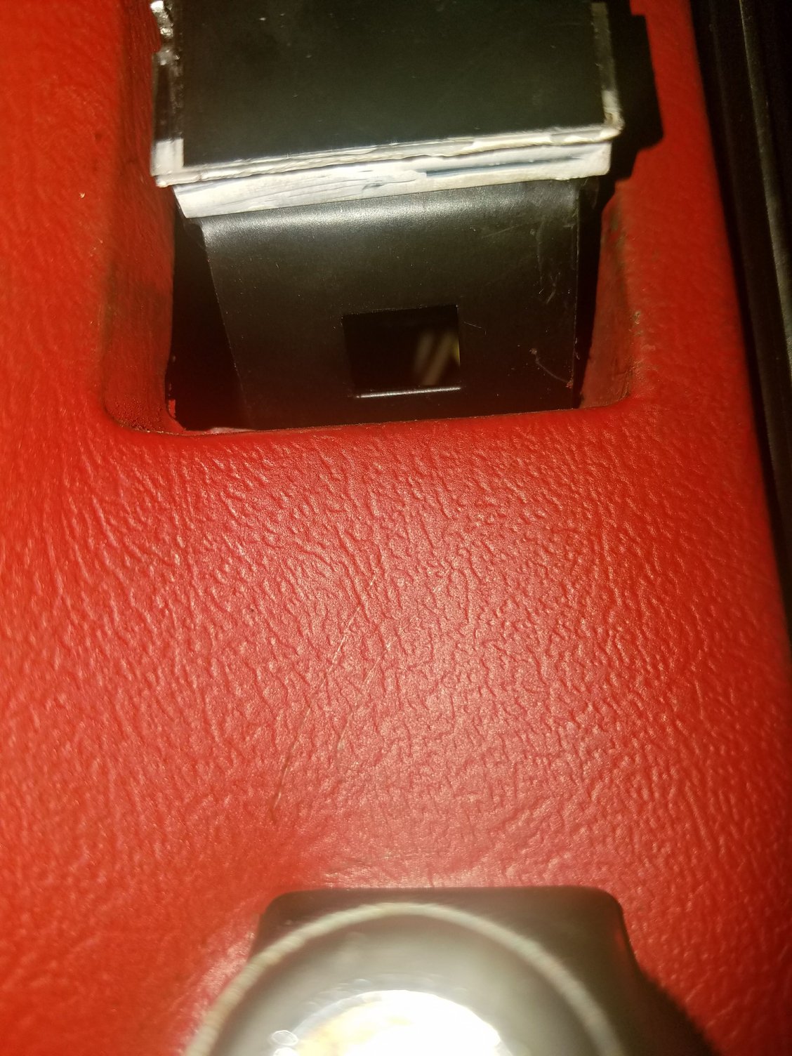

I ordered a new wiper switch off Paragon for my C3. It looks right but when I went to remove the old one I found this:
Overall View
The Top
Bottom
I don't see any way to remove this and it doesn't look "stock". Am I wrong? Ideas?

I think that's a stock switch minus the integral bezel. The switch is strange to remove. It sort of clips in at the top rear. There is a bracket at the inside bottom of the switch and at the end of the bracket is a screw that goes into the dash at an odd angle. That screw is not easy to access for either removal or replacement.

Sounds about right. The switch mounts from the back side.

Yes, that it is! It looks like someone tried to remove yours from the front...
