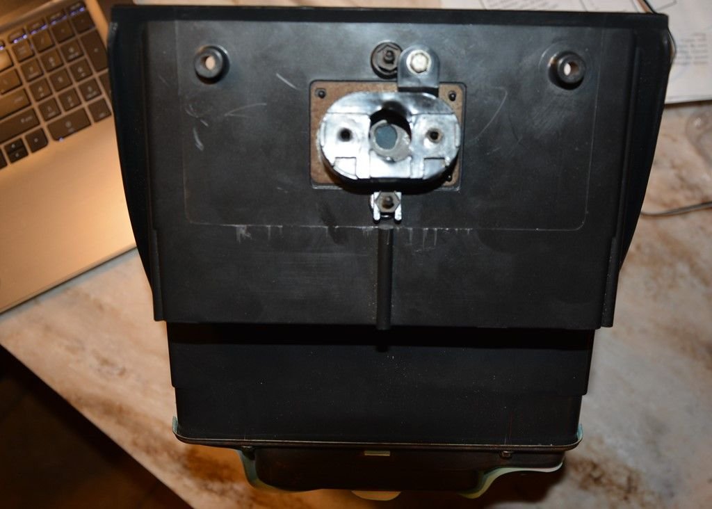

Mine is currently out of the car and I'm following advice read in this forum. Such advice is to open the light path.
This pic is looking through the newly expanded path.

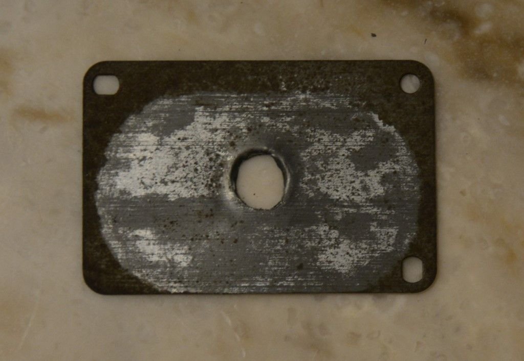

While I may have gone too far here's a photo of the metal shield just below the lamp housing. Originally the hole was significantly smaller and off center in a pressed "bubble" in the metal. In mine the hole in that "bubble" was not well placed and I enlarged it to the entire "bubble" size.
I also drilled and filed the inner hole to enlarge it slightly and make it more rectangular. Then I filed the final aperture to enlarge is slightly.
