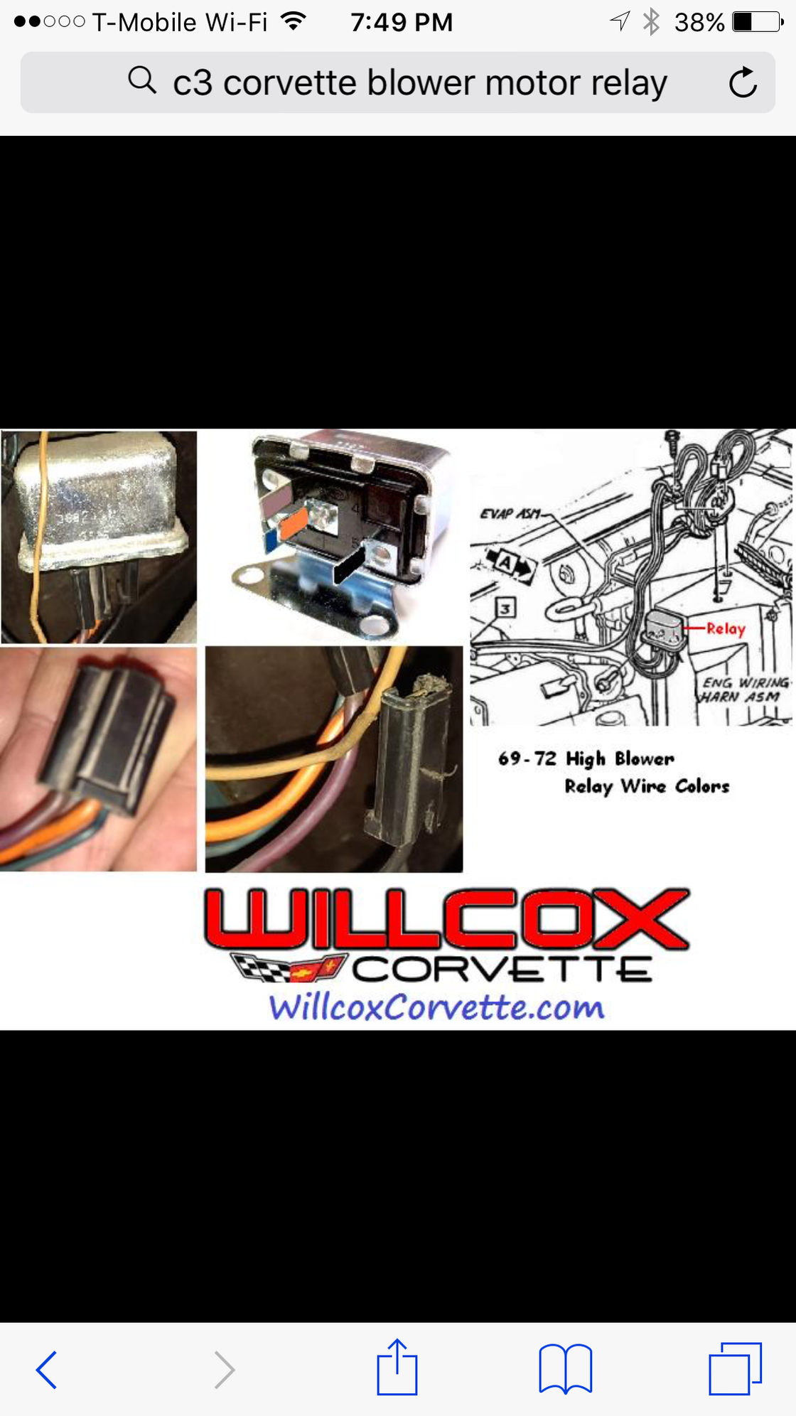

Where is the Blower Motor Relay (HVAC) - do you have a picture of what it looks like and how it's (color coded) wired?

It's on the passenger side mounted on the A/C evaporator housing.

The relay for your 74 Corvette is here, at the end of the screwdriver.
Scroll down and you will see the HVAC schematic.
https://docs.google.com/viewer?a=v&p...TRkNTFkY2E0NmM
