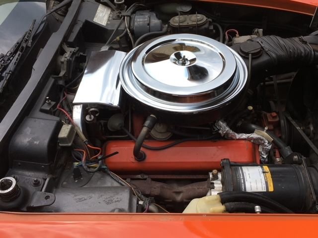

I have an early build '76 and it came with an A6 compressor!
Photo of engine with most of AC compressor showing.
