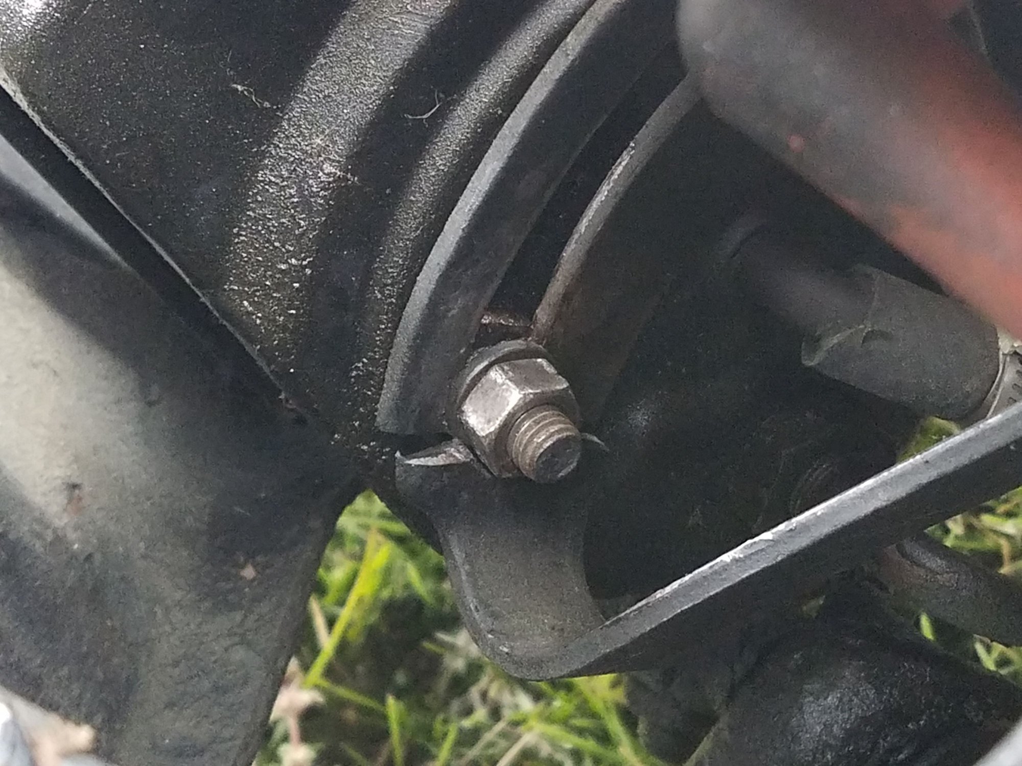

Yep, got the new bracket on without having to mess with pulley. However, now I know why my belt is flying off and probably why the adjusting bracket broke in the first place. The bolt holding pump to the carriage bracket is missing! Well, maybe not missing, but sheared off. Ugh.

Ok, can anyone give me an idea what size that bolt for the carriage pump is?
