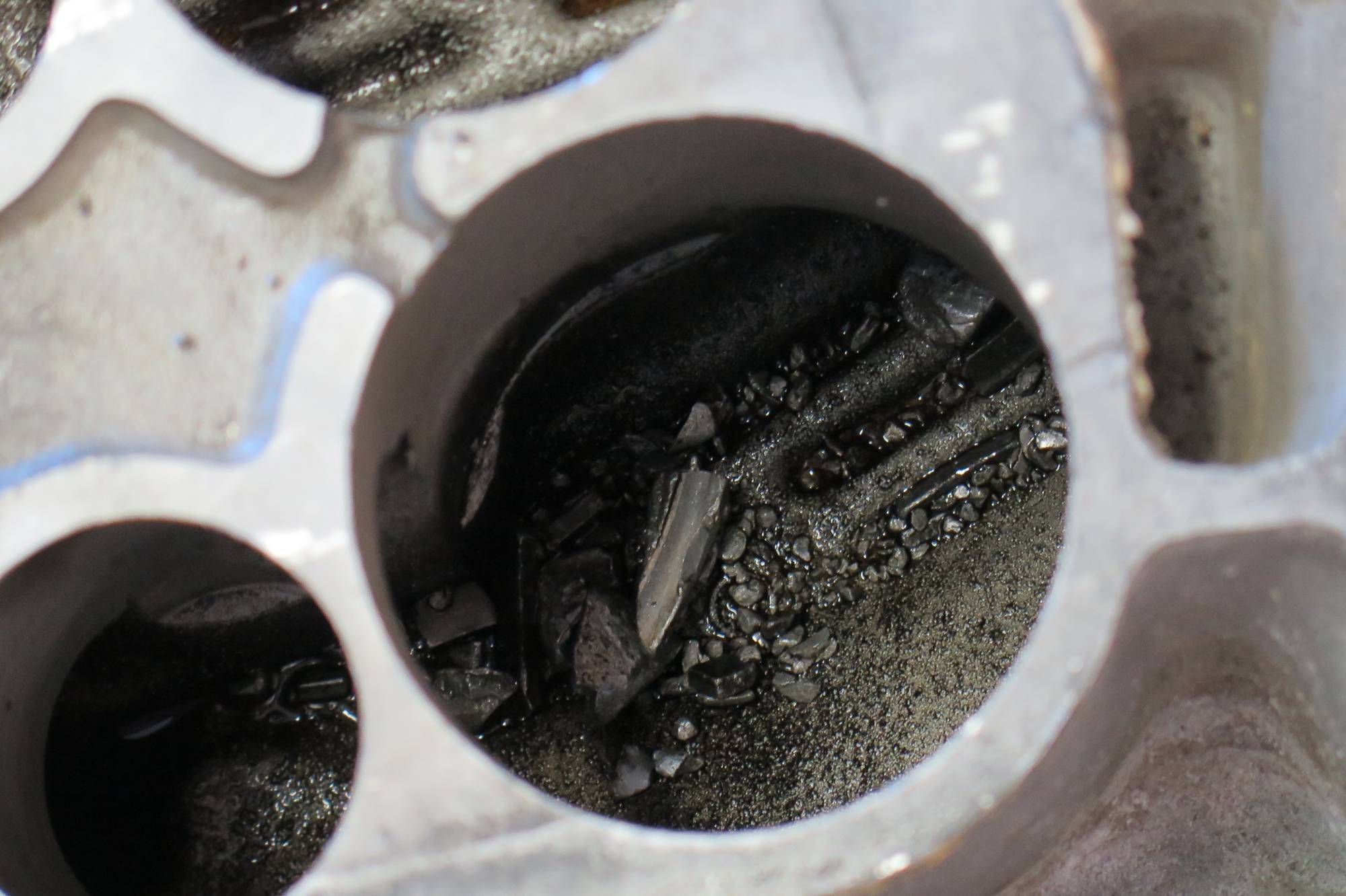

The engine will be inspected to determine why it blowed up, but here are some more pics.
One of the pistons disintegrated with the remnants distributed inside the engine:
Why was the corner filed?

For clearance so it wouldn't rub the bottom of the block at the pan rail.

Looks like a stroker with the filed down piston rods bolts. Needed to clear the block on the downstroke and possibly the camchaft on the upstroke.
That carb gasket is fubar.....for sure.
I would not be surprised that the piston was destroyed by detonation caused by the carb gasket and the carb secondaries not being able to provide sufficient fuel at higher rpm.
If that is the quality of work of that builder, you better start from scratch with a good shop.
Otherwise you will never feel safe while driving nor comfortable....what's the point in that?
Might as well park it in the driveway.
But good luck getting it all solved and enjoying it.

Would the filing not screw up the balance?
Anyway, there are few things money cannot fix. I have a new 383 crate coming from GM. I'll know next week if the 700R4 was put together by Buba.

No...the filing is done in conjunction with the balance. Part of why some look a little more filed down than others.
I have 2 383 strokers I will be building. One lower end already has the clearancing done and the neutral internal balance done.
Forged crankshaft and rods, hypereutectic pistons.
The other step is to notch the block at the railing where the pan bolts on. You clearance each rod as it rotates around. Some will hit the railing hard and need a deep notch. Others less so. But be carful not to puncture the water jacket.
Do an "advanced search" in the search function about building a 383. LOTS of great info there.

If the primaries, let alone the secondaries were not opening enough, you were running rather lean, which may be why the piston let loose. I would definitely NOT use that shop again for any reason. What 383 did you buy...Specs? The next one hopefully will put a **** eatin' grin on your face when you hit the loud pedal.
