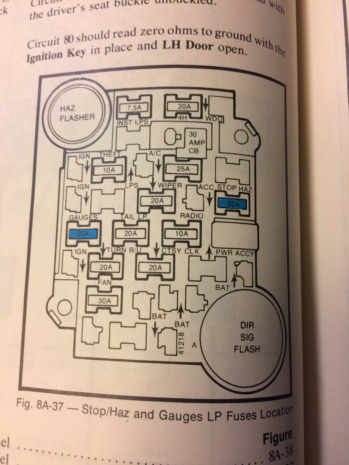

The brake fuse is the same as the stop hazard fuse in blue, correct? I got some funky fuses that won't allow me to check them with the light.

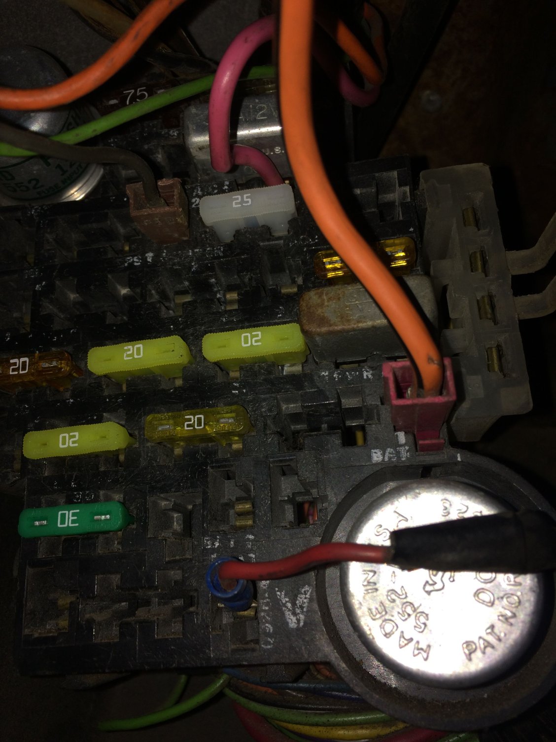

Old Feb 27, 2017 | 08:53 PM

You can test that type of fuse by grounding one end of your test light and probe the metal slit to the left and right of the fuse rating.

I went to autozone and got more 20A fuzes and hazard fuse. I wiggled the 20A STOP HAZ fuse and my light started beaming in the back, then it started to smoke so I yanked the fuze out. I went to put in another fuse and it sparked so i disconnected the brake light switch and now I am at a loss what to do

The turn signals work. I replaced the top hazard flash with a 552 however I haven't changed the bottom 552 yet.
The hazard flashers do not work.
I am working on a 1980.
That smoking fuse was a definite freak out.
