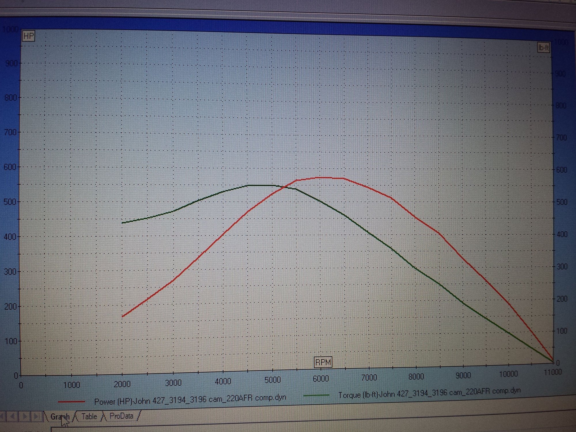

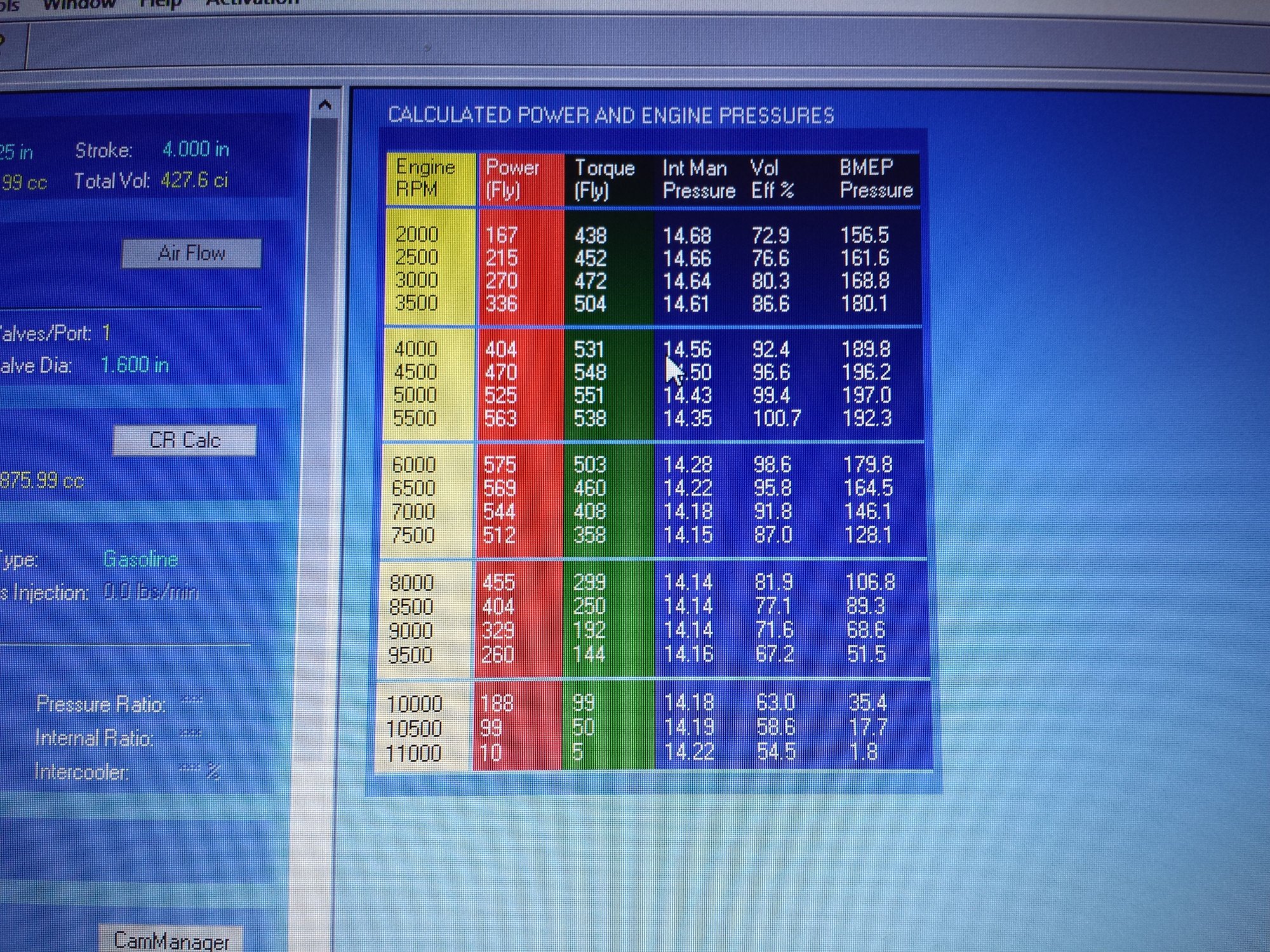

Any comment to this cam?
Drivetrain/car:
1969 Corvette Coupe.
3.70 rear, 255-60-15
TH2004R transmission (build for 650hp)
SBC Dart 427 550hp/500tq, AFR 220 competition, 1 3/4" headers, and 2½ exhaust
EZ-EFI 1.0
http://www.torqueconvertershop.com/5...aptor_lock.htm
Cam:
Old Mar 2, 2017 | 04:27 PM
C3 Stroker's Avatar
C3 Stroker
Posts: 3,921
Likes: 731
From: Youngstown Ohio
No recommendations from Comp? From my experience, the stock converter with that cam will cause you to "lurch" at idle; a 2400 stall will allow a smooth idle and better performance off the line and be very efficient at top end; a 3000 stall would allow an even faster E.T. but be slightly more noticeable (slippage) on the street....it can still be tight on top end if a good quality, however. Above that, for max performance, you would have to know the RPM where the engine makes it's peak torque (dyno info) and custom stall the converter to match it.
It comes down to your intended use for the car, and what you want.
Old Mar 3, 2017 | 12:36 AM
c3_dk's Avatar
c3_dk
Joined: Jan 2008
Posts: 3,791
Likes: 428
From: Aarhus, Denmark
They don't reply me, I've asked.
Its at street fighter car, no racing. Driving with my kids ec ec.
I will not be driving down the Germany autobahn a top speed
Here is what I get from Dyno 2003

The only thing I will add is if you are running the lock up for the torque converter there will be little to no effect when cruising on the highway with the higher stall. IMOP a good converter is a wise investment.
Old Mar 3, 2017 | 01:40 AM
