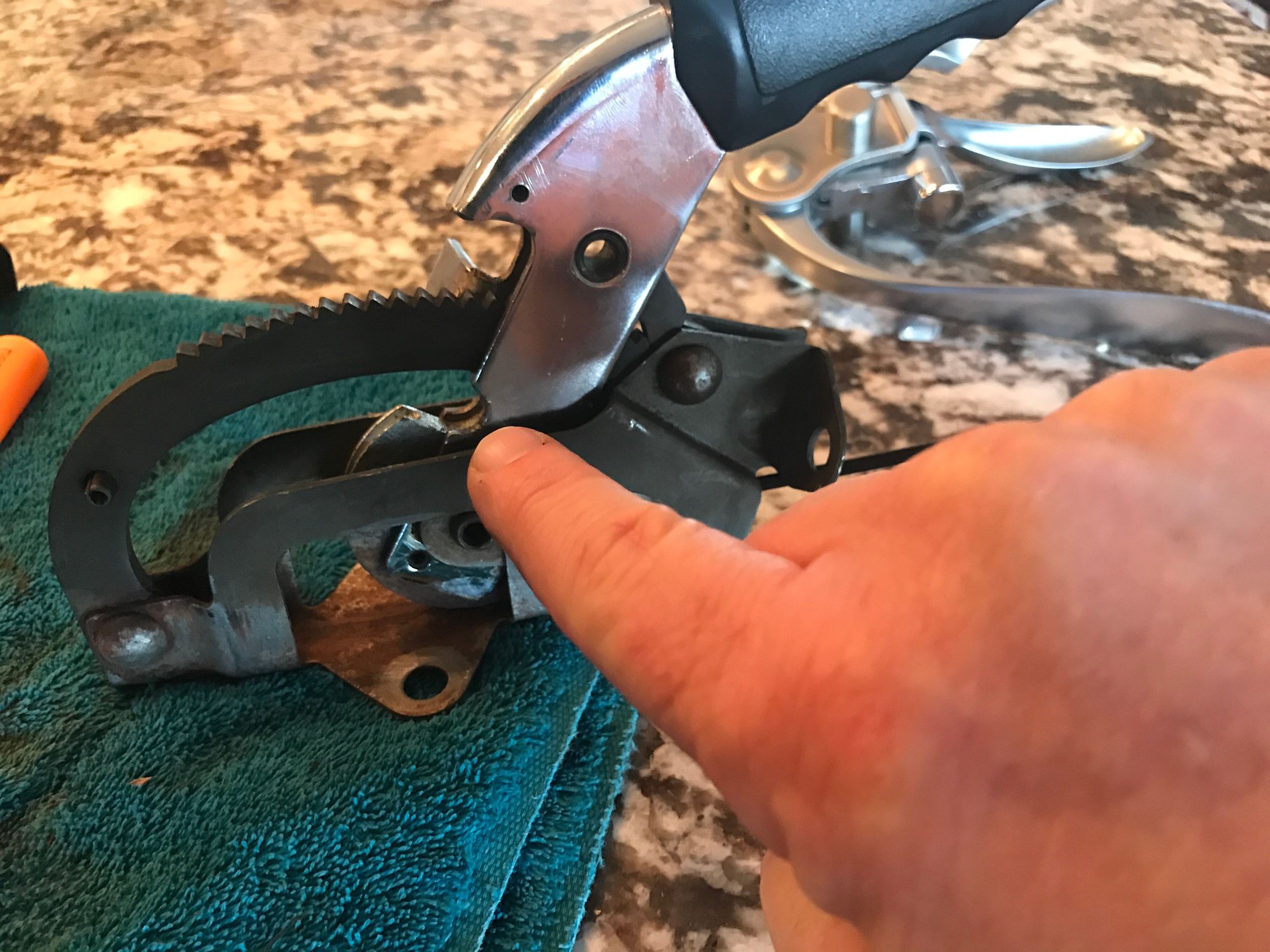

I can't find any threads that address this particular hand brake issue. I bought a new front cable but when I removed the hand brake, there was another cable that was rusted apart. I can't find any information on here or the manuals that I have. The cable was right in the middle of this picture. What is this missing cable called so I can order it

That cable was not serviced as a separate part, it was made into the handle assembly. The only way to get it is either purchase a new or used handle. You can see the red outline in the picture below of where the cable travled. I suppose you could remove the two housing rivets and replace it with a used cable or just replace the entire handle assembly.
I have a pretty nice used handle assembly for 50.00.
