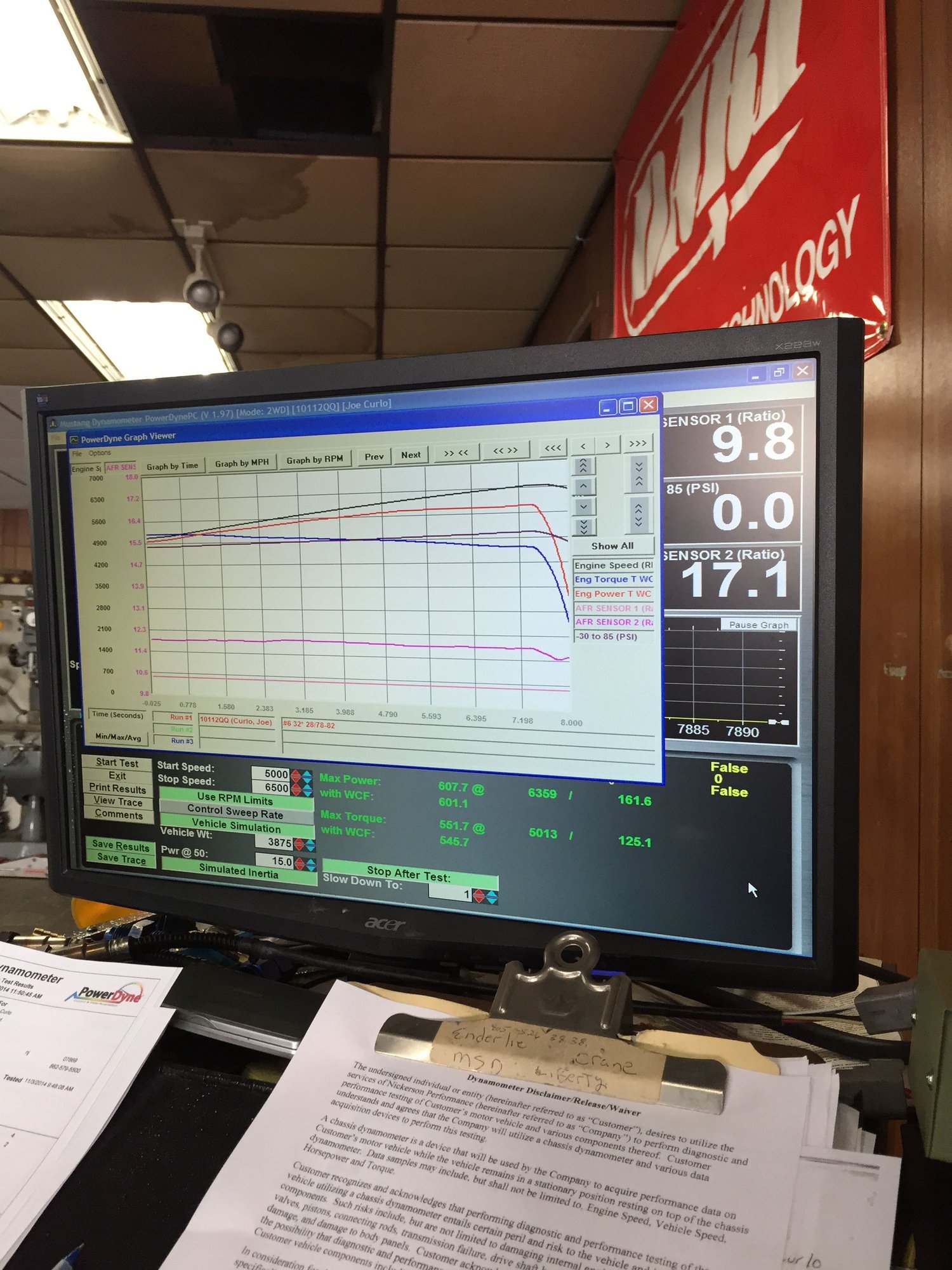

Here is a little run down on what I have:
The rear is getting the Toms 30 spline HD inner axles and spiders, Steel cap, solid crush sleeve (shimmed), clutch packs, bearings and the Gear set shown. Pretty much all the same parts that are in the "Super 10" that you mentioned. The only difference is that I am not having Mike (Track Dog) do the work. I've got a little experience building rear differentials, so I am doing it myself.
I have already installed the HD 31 spline outer axle shaft kits. I also installed new 3 1/2" aluminum drive shafts (front and outers) that are rated for up to 1200hp.
I removed the Th350 that was in the car originally and upgraded to a Tremec TKO-600 transmission, flywheel, clutch kit, etc. from Kiesler.
For the engine, I pulled out the old 350 and built a SBC 400 with all the go fast goodies in it and added a old school Holley 250 supercharger with dual carbs built for me by Nickerson Performance in Bristol PA.
I am running fairly low boost (8 lbs) since this is mainly a street car that I drive often and can be driven on 93 octane in any weather conditions that you can think of without retarding timing to get it to run without detonating itself to death.
I did not dyno the engine before I installed it in the car, so I don't have any numbers on that by itself. However, I did dyno the car at Nickerson Performance on their Mustang dyno when I completed assembling the car.
Here is a screenshot of one of the dyno runs. This was not the final run but it’s one that I have on my computer. The graph doesn't show your typical HP and torque graphs because I was focusing more on air/fuel ratio so not to burn up all my hard work. You can see the HP/Torque #'s on the lower part of the screen. I was never big on chasing numbers but rather building a dead reliable car.
Link to the car on the dyno.

Hey Joe, great dyno numbers and nice video. I can loan you my drag radials some time if you really want to get an ET to match your 124 mph trap speed.

Wow!!!! Super fantastic!!!! Supercharged👍😃:-)
I would suggest you get everything cyroed as well.
You got my dyno numbers beat that's for sure but I'm normally aspirated not supercharged :-)
But not by a lot and I think my torque is right about there just a slight bit less

Thanks for the offer Bruce. I did have drag radials (Toyo 345/40R17)the last time I saw you. I just didn't have a line lock installed so I couldn't heat up the tires enough to get them to hook. That's been taken care of.
You mean to tell me that you didn't like the 1.99 second 60ft times that I was running?
The 124 trap speed was when I missed third gear so hopefully it will be higher next time out. I also need to put this thing on a diet. You can see in the dyno screen shot, it weighs in at 3875 without me in it. (Fat Bastard!)
You have a real nice engine in your car. I remember reading about your build. You are squeezing a lot out of that engine.
