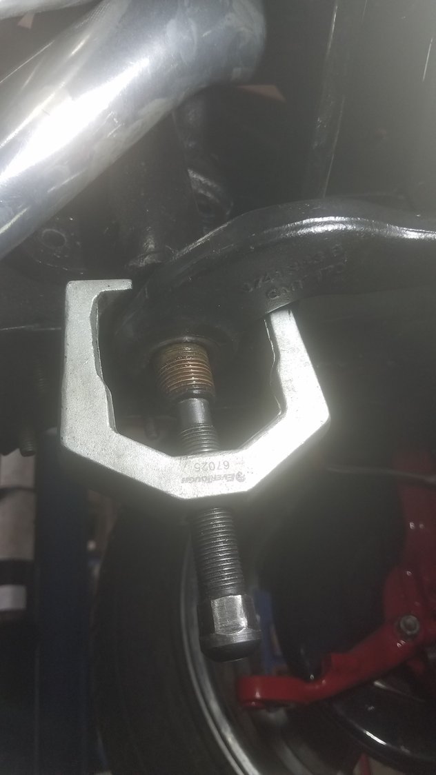

removing pitman arm: i couldn't get pepboys pitman puller to seat correctly with steering box in the frame. I removed the steering box and used an impact gun to remove the nut.
Removing pitman arm using impact wrench, steering box removed from car.

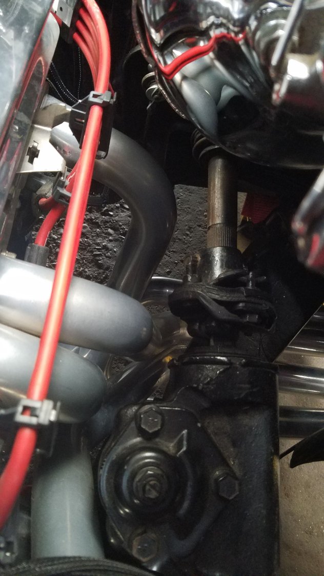

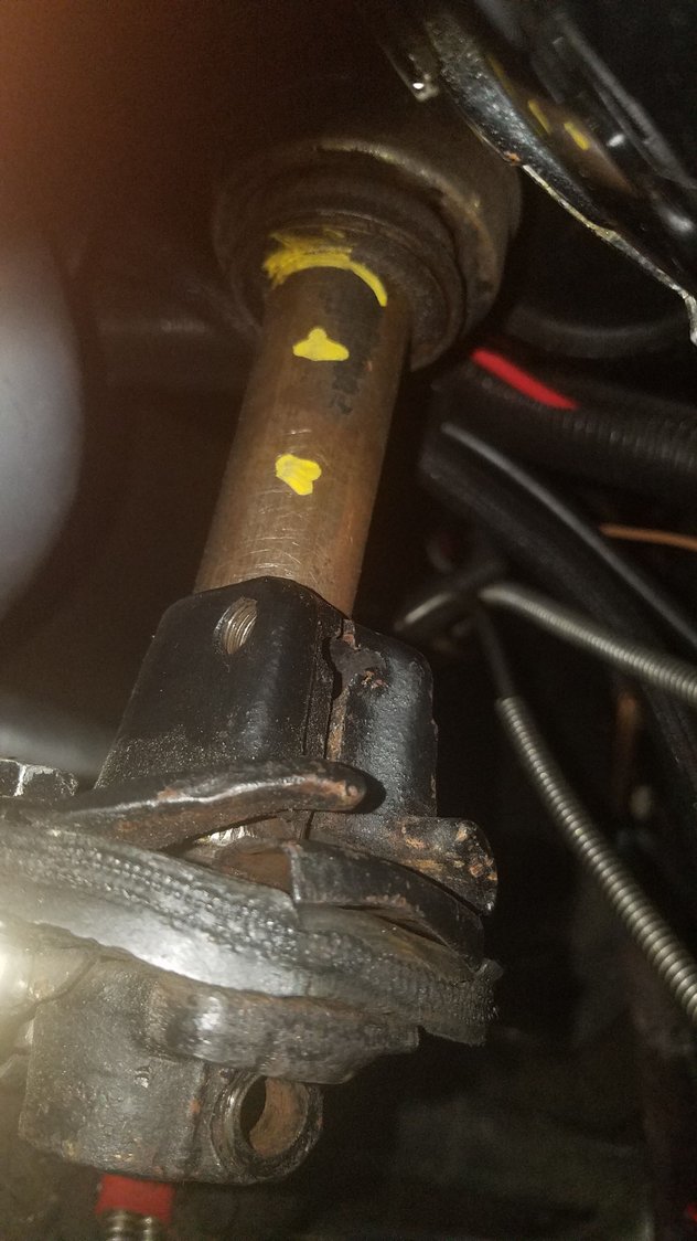

steering column: with steering column removed from car, I soaked slotted end with pb blaster and then wire wheeled it. Then the rag joint fit without issue.

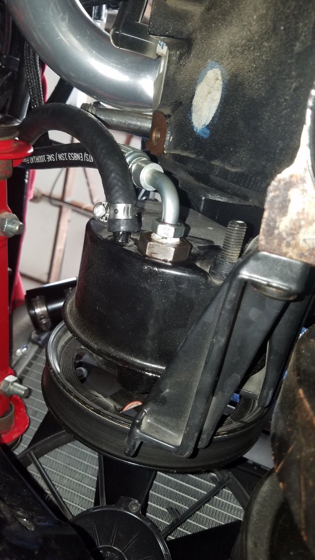

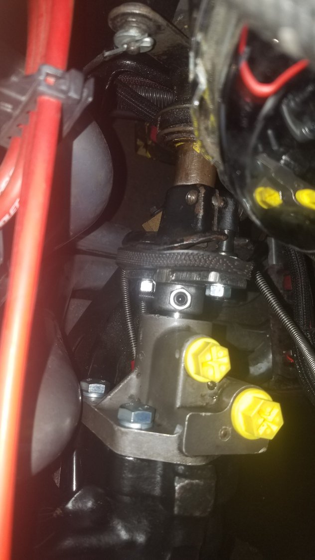

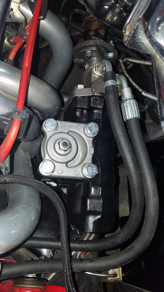

I went at it this evening for three hours.I didn't finish but I managed to collapse the Column and install rag joint and Box. The bad? I had a big delay due to not finding my 1"5/16 socket for the pitman arm nut. had to go buy one. also had a hard time sliding in the rag joint into the column shaft even after filing and cleaning the end edge to deburr some just in case that was the issue. Still no dice! I ended up using half of my old piece,the one that goes on the shaft. I felt a little guilty removing almost new P/S hoses,control Valve ,rebuilt gearbox, rebuilt cylinder . Im looking forward to tomorrow. I'm guessing I should finish it.

I remembered your tip. Thats why I went with the old half! I was risking pushing the shaft too far in had I kept messing with it. I just finished a while ago. Fixing to take it for a spin.

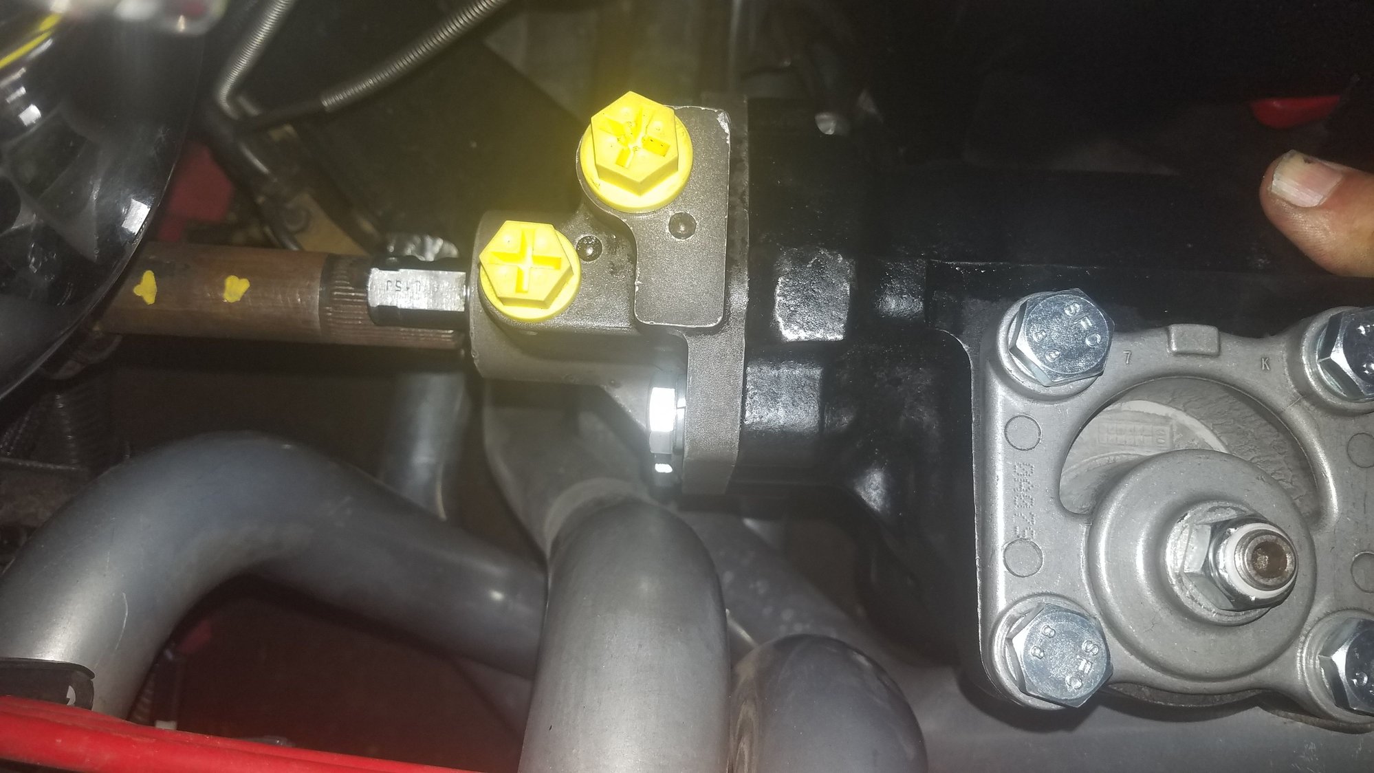

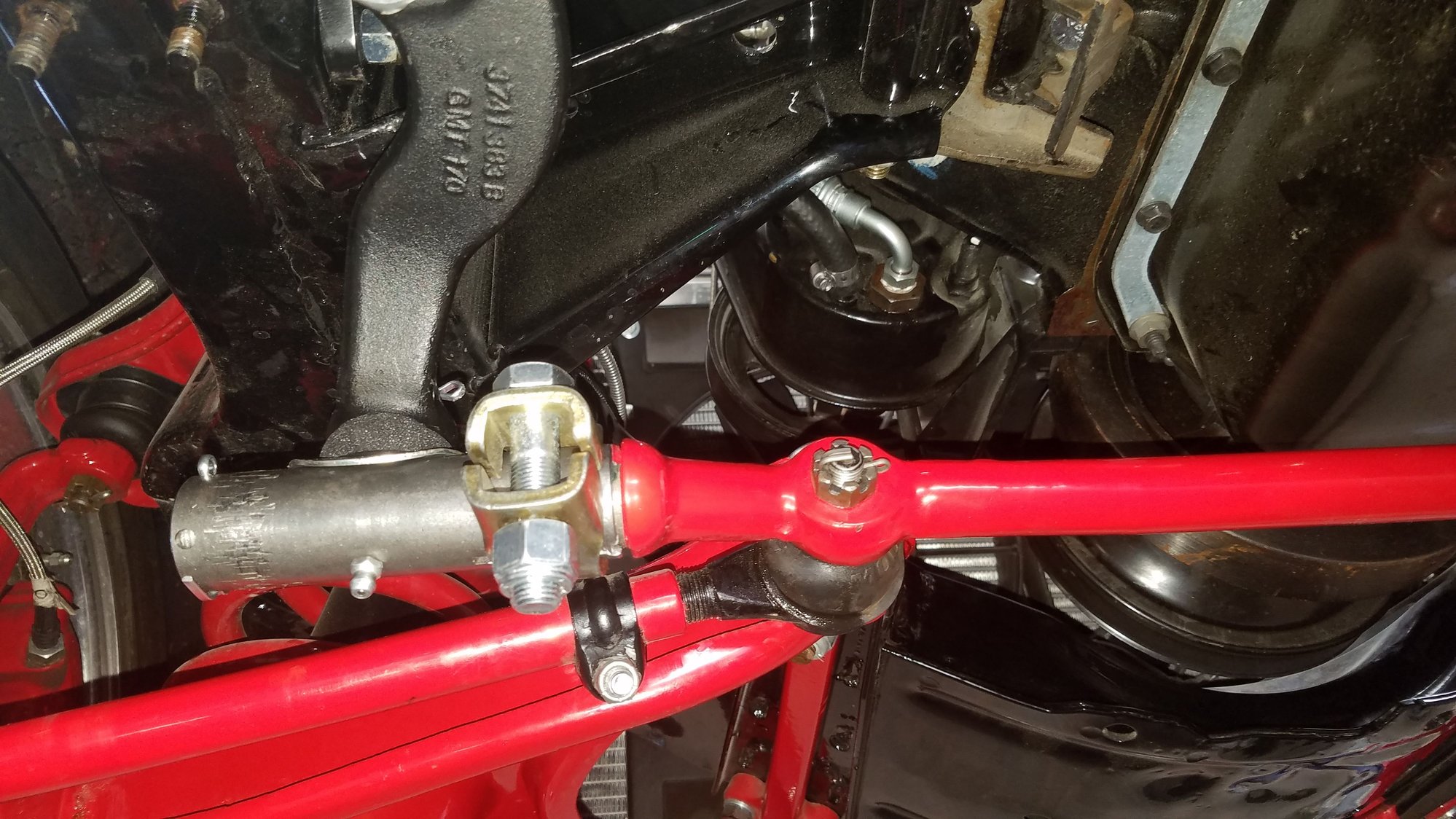

All I can say is wow! The difference is like night and day! I'm looking at a 6 to 7 hour project If anyone wants to know. Today's delay was the Control valve adapter.It wouldn't screw in enough to bite on the threads. I took a break and called Borgeson to ask them if this was a common problem and how to tackle it. the Rep responded that they have never had that issue before. told me to keep playing with it and that if it didn't work they would ship me another. I finally got it to bit a thread and then I used a Rubber mallet and tapped on the end toward the threads as to push it in far enough to grab continuous threads. I had to used large channel locks to thread it all the way in since it went in straight but under some pressure which I was very comfortable with. I topped it off with the supplied clamp to lock it in place. I heard some stories on the installation of the hoses but I found them to be the easiest part of the conversion. Borgeson did a magnificent job clocking the hoses to ease the installation. hope this mini review helps someone and big thanks to all you guys who chipped in with all the tips to help with this installation .. Thanks Again!!!!!!
