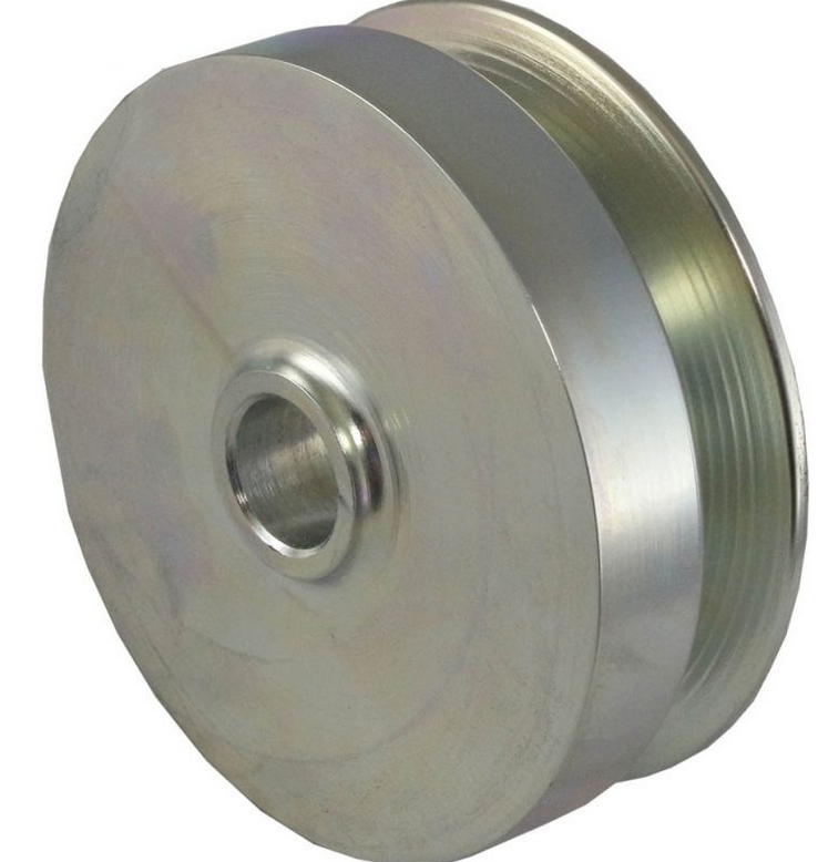

My 68 convertible came without an alternator so I bought one from a local
parts store. I installed it not knowing that I would need to change the pulley as is shown in the pic. I removed the alternator and took off the pulley and ordered the correct one for my car, BB with AC and PS. The problem I have now is that the pulley doesn't fit. It's as if the shaft on the alternator is too short. Do I need to replace the fan on the alternator as well? Thanks in advance.

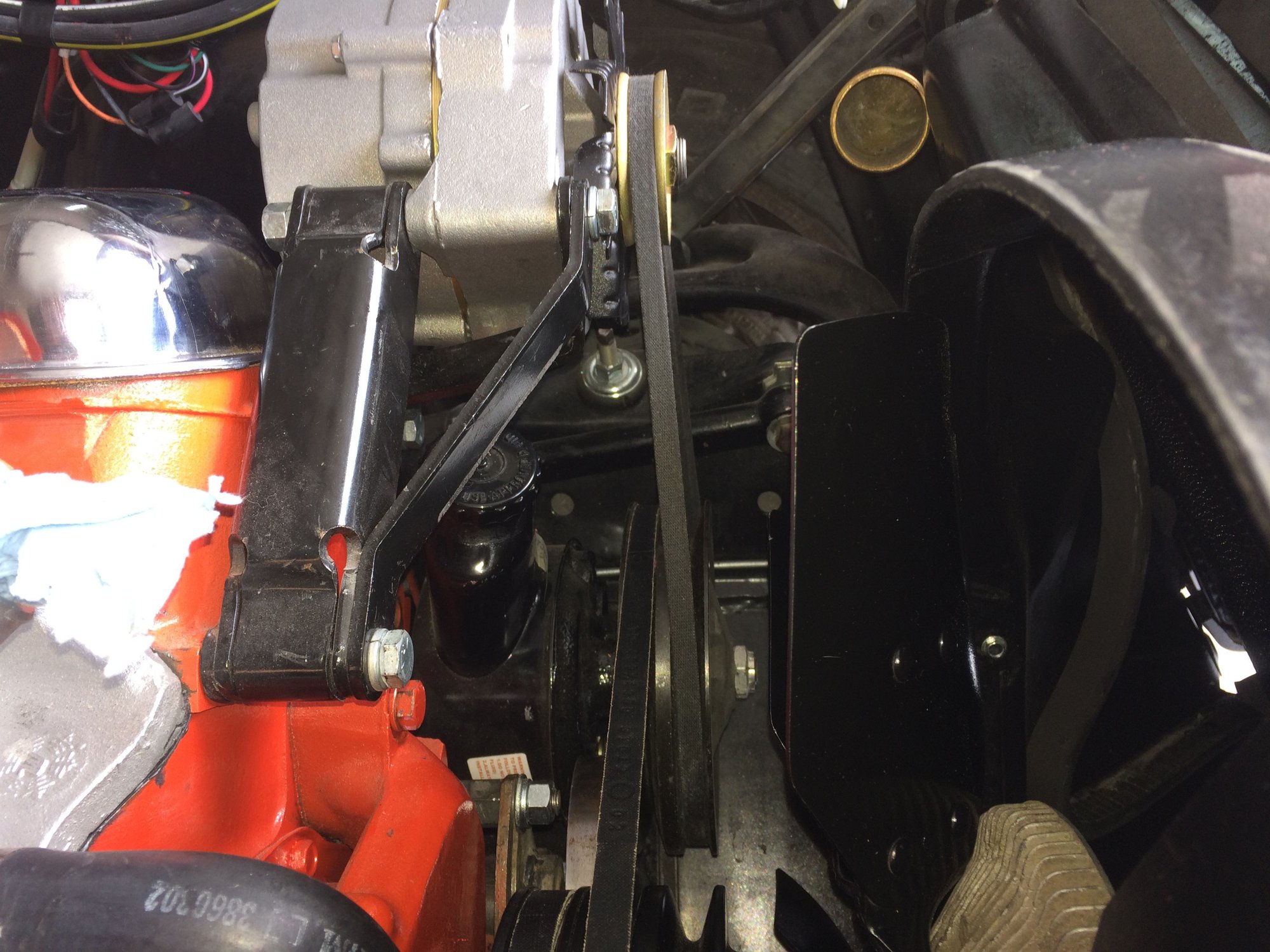

Here is how mine looked with the wrong pulley.

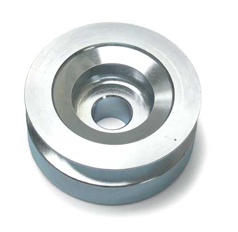

You should be able to reuse your fan. If you have the correct pulley there should be a large counterbore is the front of it for the nut.
That looks like the one I bought. I'm beginning to think I may have the wrong alternator.
Look again. That pulley has a 1/2" offset.

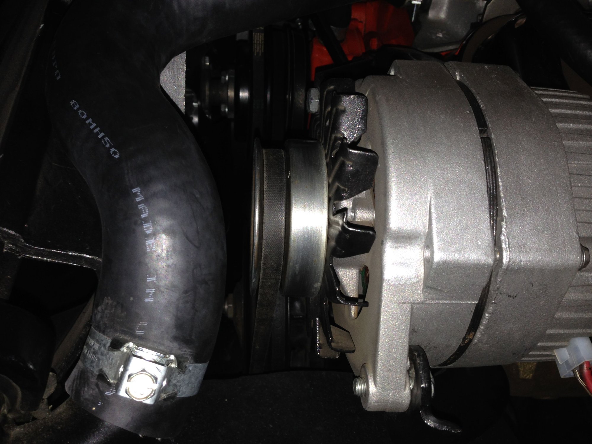

Sully
Maybe it is your fan. I went and looked at the cheap rebuild alternator I got at the local auto parts store that I used for parts. It has a raised portion on the front on the fan. I see other fans on Ebay that are indented as shown in the first picture. What does your fan look like?

Old Apr 13, 2017 | 12:25 AM
sullyman56's Avatar

Mine looks like the second fan. Maybe that's the problem.
Old Apr 13, 2017 | 11:16 AM
JC68's Avatar
JC68
Joined: Nov 2014
Posts: 463
Likes: 129
I think that has to be it. The correct pulley has a flange on the back that looks as if it supposed to be a spacer to fit into the indented fan. With the raised fan I can see how you wouldn't have enough shaft for the nut.

I ordered the correct pulley for my BB not knowing if it would fit, but it did. Here's mine:

Below is an original 69 427 alternator pulley which should be the same as your 68. The spacer width is 5/8". Like said above, that should be your problem.

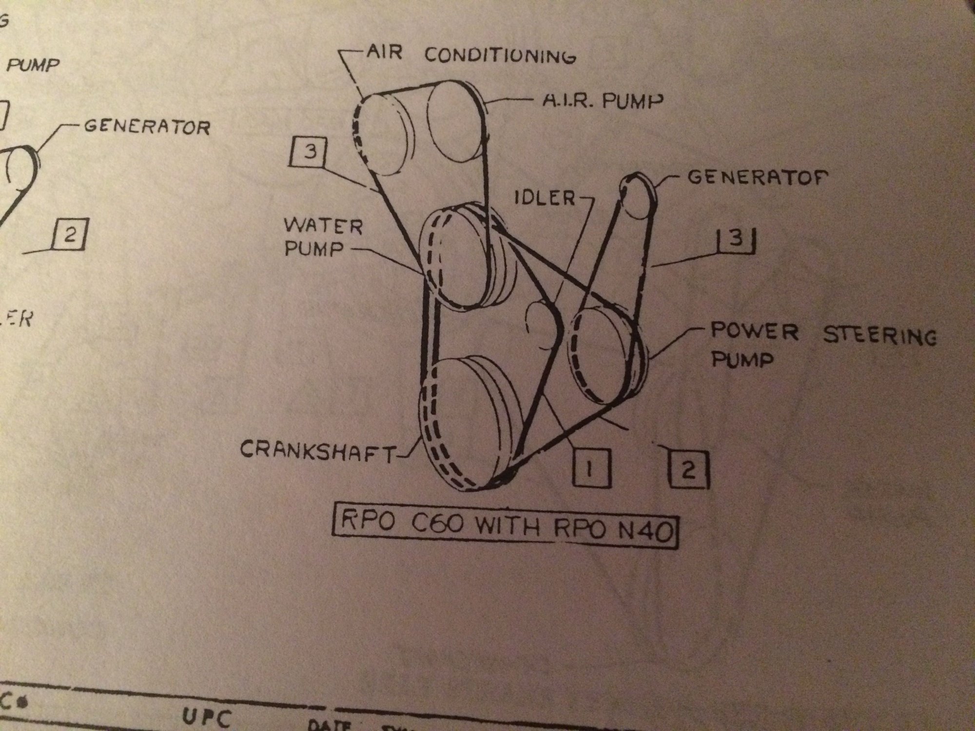

Yep - need the odd pully. Plus - shouldn't the alt run off the rear ps pulley and not the wp pulley?

As per the AIM, the alternator belt is routed on the outer track of the power steering pulley.

GM part number for the pulley is 3883978
Corvette Central number is 302013. Expensive there at 45 bucks....
