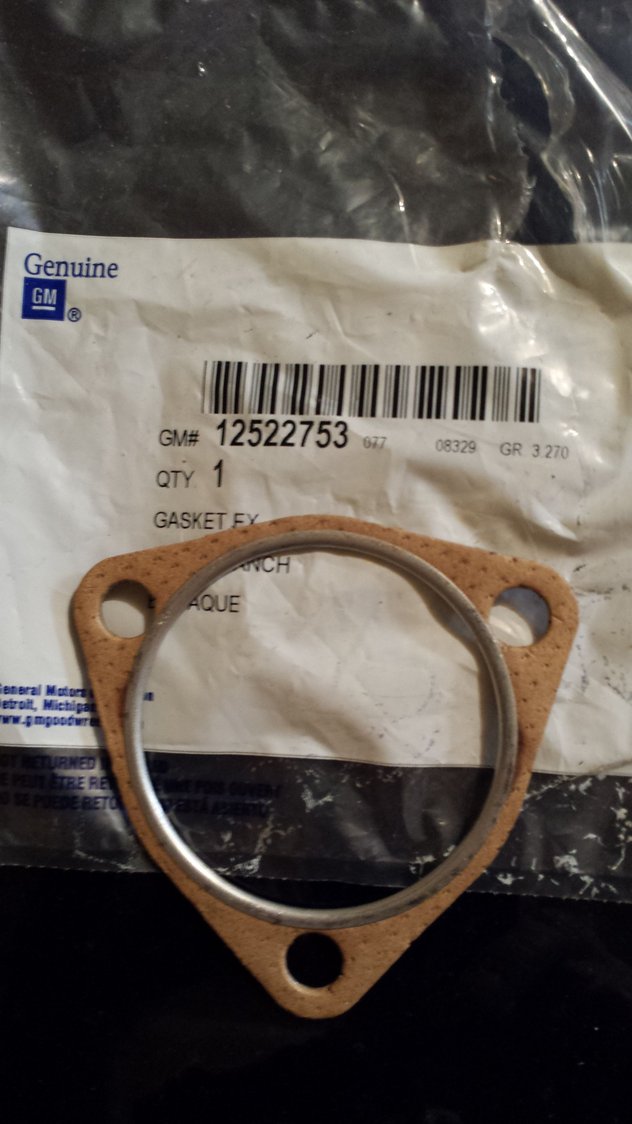

The gasket between the manifold and the riser was triangular with rounded corners, holes for the 3 studs, and a steel ring around the 2" center opening. Again, Any parts store should have. If not, let me know and I can send you one.

St. Jude Donor '09
I just bought one of these yesterday $2.99
FELPRO
Hide Image
Part# 60083
Exhaust Pipe Flange Gasket
