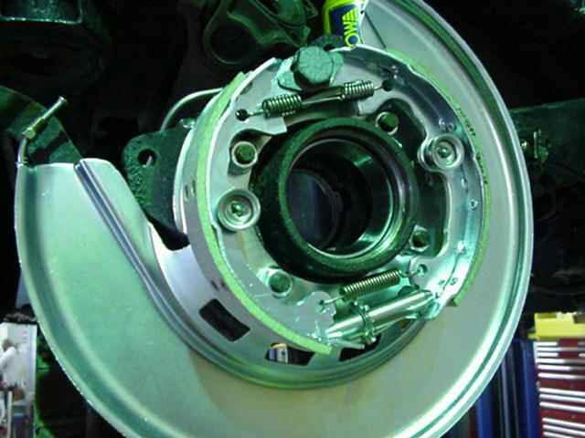

Hi,
We are working on a 69 parking break here in DK.
Can anyone tell me, what this plate does?
Does it has more then one funktion?

It helps keep the shoes in place and the bolt from backing out....The tabs are bent after installing. Below is the best pic I could find....I didn't seem to have one from by build.

Torque the nut to 60 ft/lbs and then use a punch to flatten the sides against the bolt. Attachment 48086400
Attachment 48086401
Attachment 48086402
