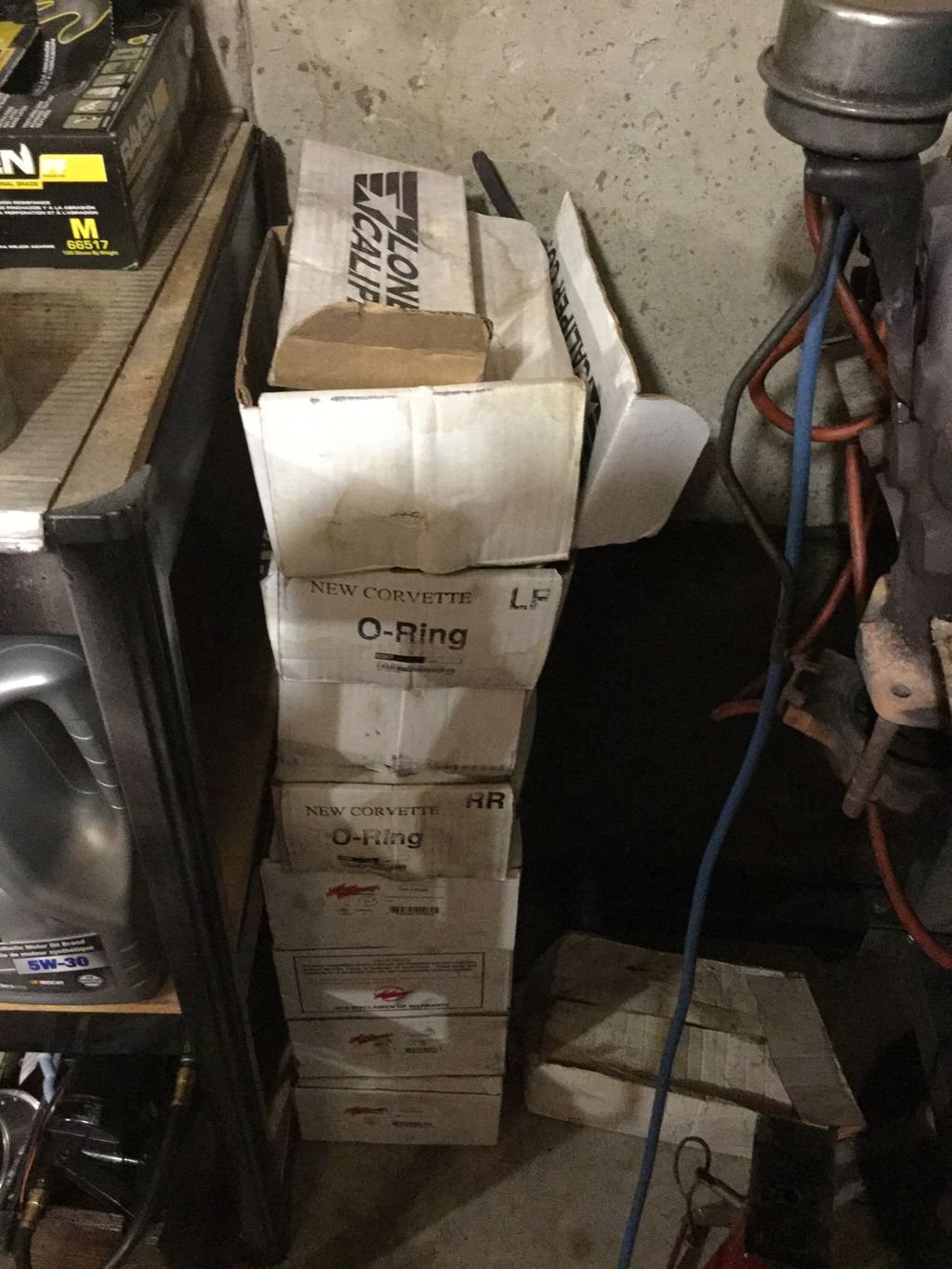

Here is my pile of calipers.
Went with Wilwood D8-4 all around, plus new rotors. But as others have noted, check rotor run-out, this will make the problem return much quicker.
