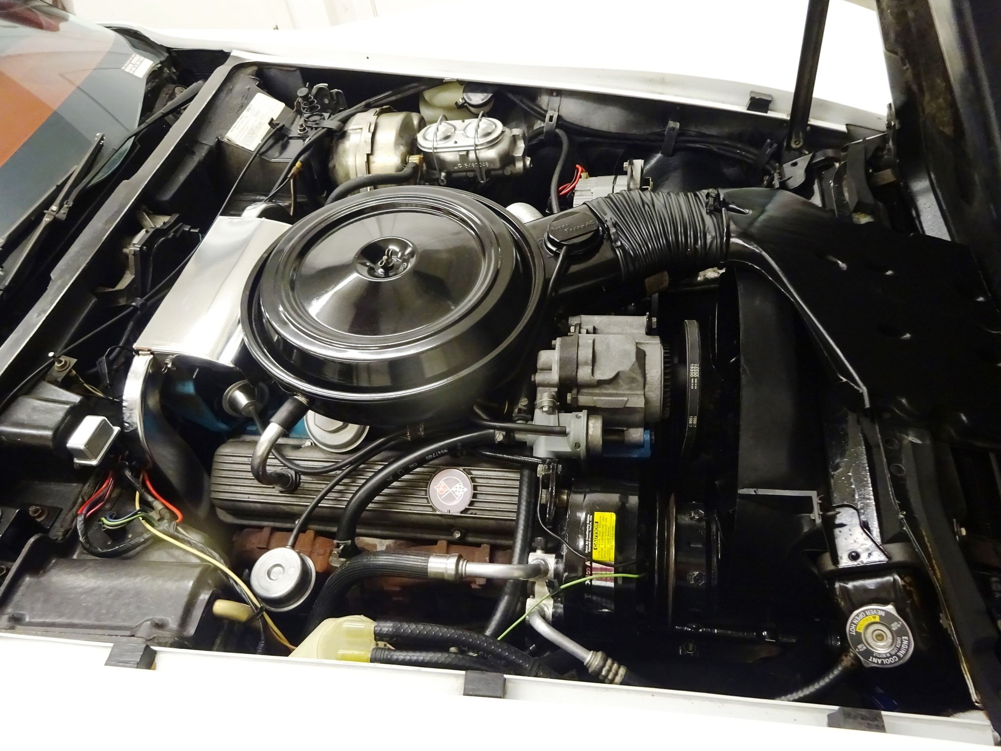

An unmolested '77 L82 engine bay, just for reference.
It's a LITTLE bit molested.... The distributor covers were plastic, not chrome. I'm not sure if that's a replacement aluminum MC, a painted one, or just a brand spanking new one, but WOW. I have no hope of my engine bay looking that clean anytime soon.
Adam
The MC is original, just cleaned up and painted Eastwood Brake Gray.
All L82s, at least in '77, came with the chrome distributor cover. The L48s were black plastic.
