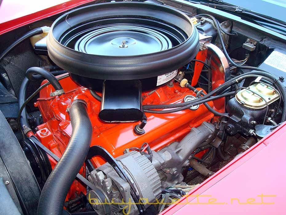

clean looking motor you got there Gusto

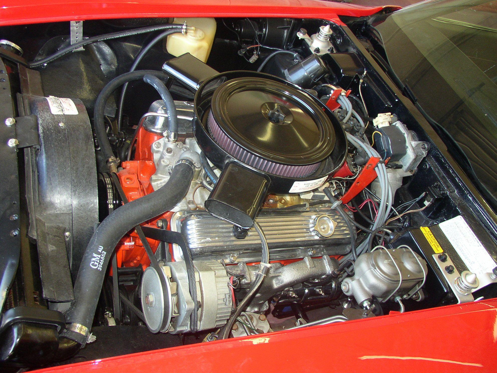

the second one is mine taken as we were reassembling it after finishing up a frame off.
GUSTO
