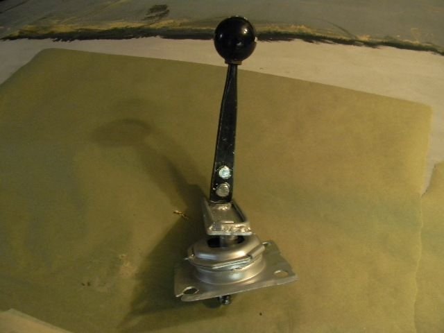

The shifter - it's going to require an adapter- but not to tough to whip up- several forum members have done it.
Here's m my trans- got it for about $300- went through it- replaced the rear seal-
Here's some pics- thanks to "john65"

Hi Richard. Here's another, the one you posted on the cardboard is from a conversion done on my 68.
This is the one on my 77. After this pic was taken I put the dummy vette stick on to give it the correct look. OP as you can see it comes up and over several inches to the left. Good luck, love mine.
