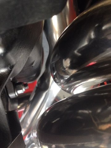

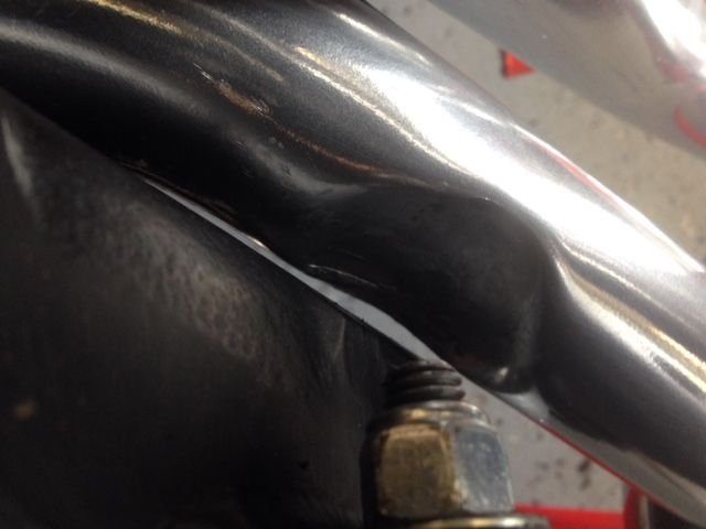

I thought I would post how Doug's D380 headers "almost" fit with the Borgeson steering box for a Chevy small block. The headers have 1-7/8" primaries and are 16 guage. I had to dimple one of the tubes. Hopefully, this is helpful to others.
Richard
Adding back some of the photos for others. The headers were dented by using a socket on its side.
