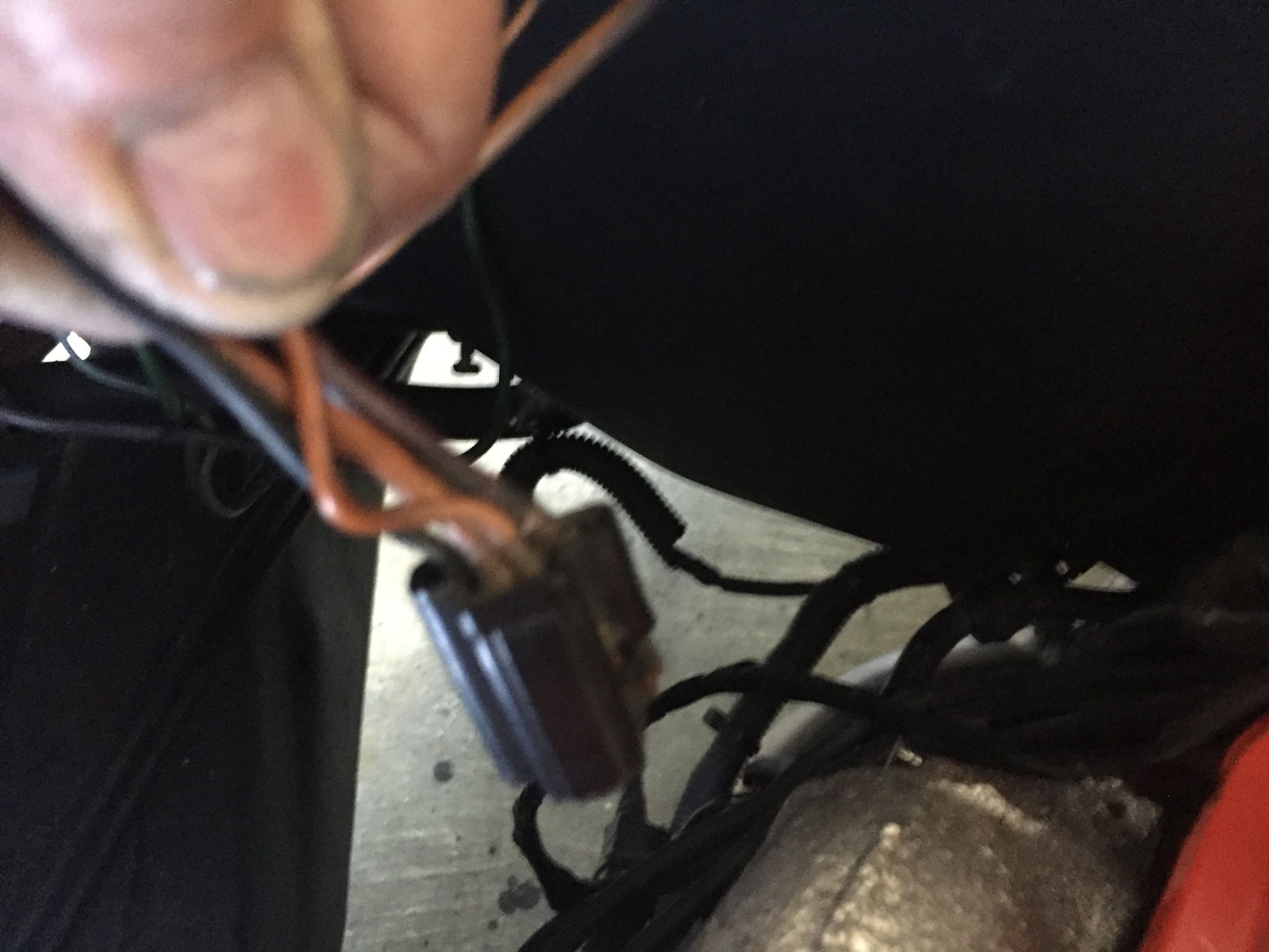

I pulled relay and check out purple wire. Toast! I jumped and crimped another terminal temporarily until I get a new plug. I picked up a used fan and installed. All back to working. But what caused wire to melt plastic plug to the point of meltdown? See pic.

Bad/corroded connection = resistor= heat.
