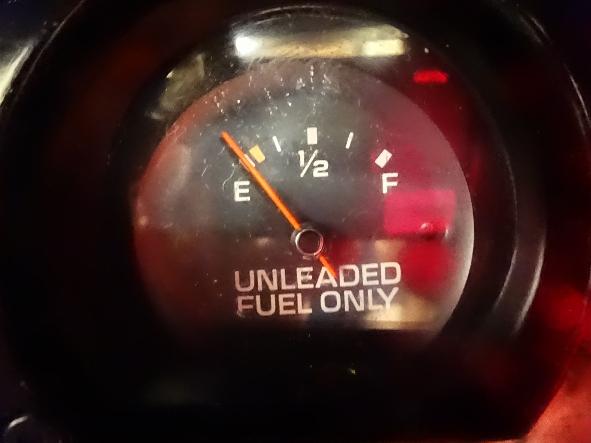

Upload the file above and save it to your desktop. Then look at the picture below and post what your gauge is reading... A fuel gauge in most cases will tell you what the issue is and that will put you on the fast track to fixing it.

Gauge is showing dead empty:
