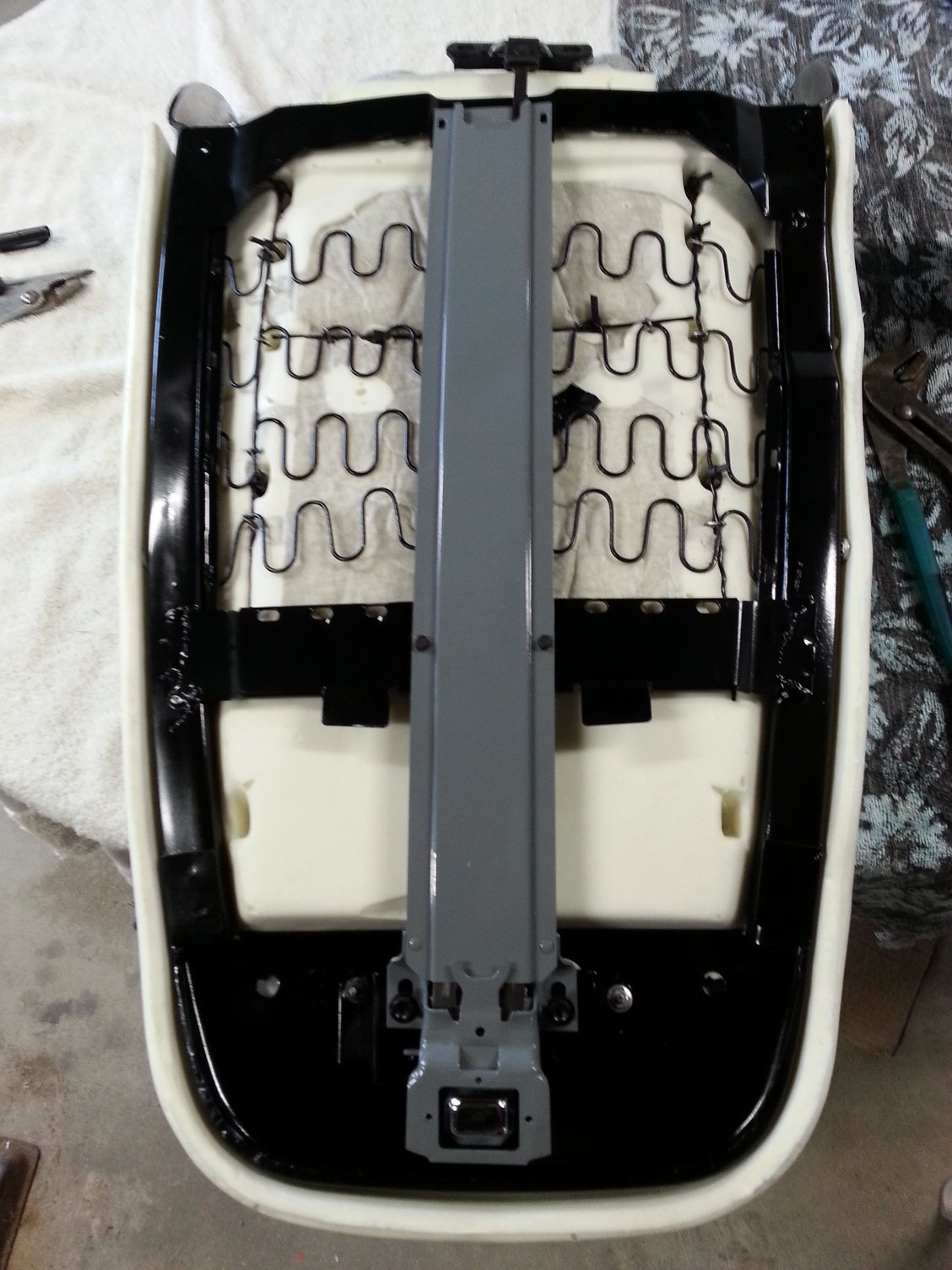

I bought new foam and leather covers (CA) for my 74. I couldn't find anyone who was interested in covering the seats. I reviewed the videos and decided to go for it. Once stripped I welded up and beefed up the frames. Cleaned and painted them. Ordered some new clips, buttons and dyed the seat backs. Came out great.
