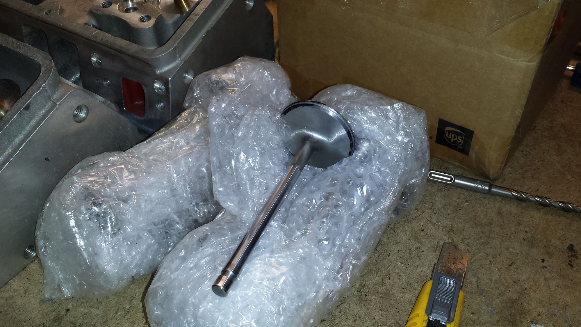

Hi,
I have a set of pro coms heads in my stock, that I would like to sell.
I have the heads and the valves, it is 2.05/1.6
But springs, keepers ec ec are missing.
I would like to buy a "set" to finish the heads, so I can sell them.
I'm not looking for any high end parts.
What would you recommend?
