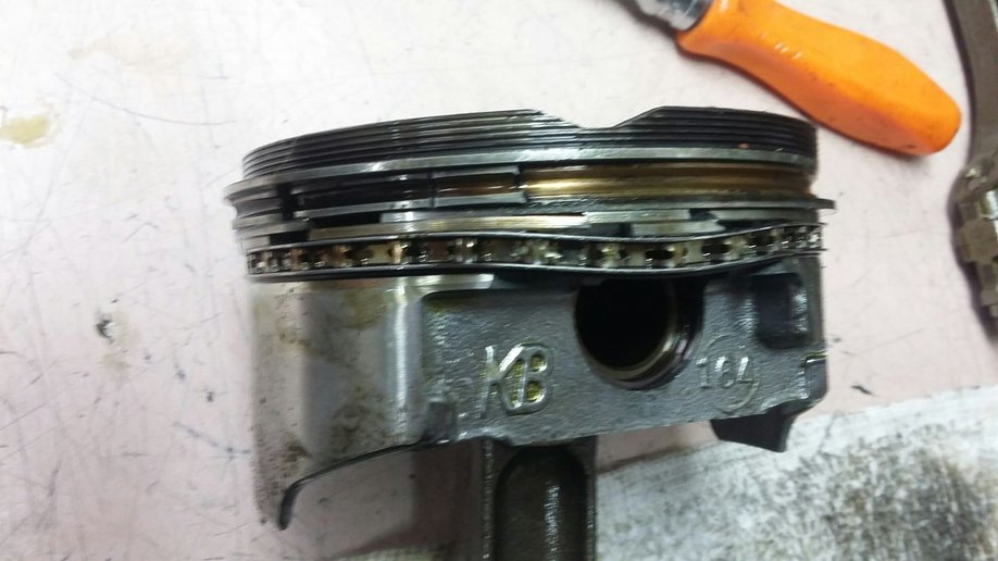

Yeah, it definitely looked like detonation to me and should have guessed it was sudden by the looks of things vs. over the long haul. However, I recently saw something very similar with KB cast Hypereutectic pistons and it was definitely over a long period of time. I'll see if I can find the pics I took. The denotation wasn't coming so much from timing as it was running the motor WAY to fat for a long time, years. Too fat/rich will cause the same type of issue by washing the cylinders and unseating the rings which can cause gaulding as well. Un-burned fuel trapped between the rings as the piston comes back up will ignite and try and push the piston back down, thus hammering the lower rod bearing. Those types of catastrophic piston failures can be rather expensive for sure. Like I said earlier and like others. Using a Hypereutectic piston is NOT the way to go if you are building a performance motor and certainly not for a 383 or higher build just to save a dollar. Like the trans commercial from back in the day said, "you can pay me now or you can pay me later" for not doing it right the first time. Thanks for the pics.
Found the pic of KB Hypereutectic piston that was fuel fat and didn't like it after a while. Another reason NOT to use them and not to run too fat on your tune.
Fuel Detonation over time
Are you describing pre-ignition here. Ignition of the fuel independent of the spark plug too early in the stroke.
Pre-ignition is devastating to every engine.

I got a question for you GOSFAST, how much HP was this engine producing and how high was it being revved? Any power adders? A 350 or a 383 or was it some other stroker motor?

It was probably making about 420 HP when all hell broke loose?? It definitely was on the chip which was set to 5800.
No power adders, only injected.
(Add) It was a 383" hyd-roller platform, 9.5:1 comp.
I do have a bunch of personal issues with this unit. One being the cost ($6000.00+) and getting some "welded-ball" pushrods, among other "cheap" pieces in here, for the money?? I have literally hundreds of these on the shelf from around the early '80's, that I ended up never selling. They cost us about .50/per back then! I never expected to find these in this "performance" unit??
Thanks for the info GOSFAST.
None of those numbers look to be in excess of what a cast hypereutectic piston should be able to handle. In fact I would say well below the HP level and just a little below the RPM for the 383.
Maybe it was just a poorly built and or tuned engine, and detonation was not just a contributing factor but the real cause of the destruction. Too much squish distance maybe along with open dish piston tops? Quality of the brand of piston? Poor engine cooling, using under hood hot air, Running lean, all kind of stuff that could contribute to deto destruction.
No personal experience but have read of folks running a lot more HP and nitrous to hypers and them surviving. I think it's all about tune and avoiding the dreaded detonation destruction.
I personally run hypers at 440ish HP with an RPM limit of 6,400 on a 350 @ 10.6 CR and they have survived 10,000 miles so far. However never any detonation and I use D-dish pistons vs open dish type with a squish of .038".

This line explains why that engine lived: "The sole modification to the short-block (at the advice of Jerry Stetler from Ace Machine) was to increase the gap of the top rings from 0.015 inch to 0.028-0.030 inch (we reused the original rings). The second (factory gapped at 0.028 inch) and oil rings were left untouched."
That and the 118 octane race fuel that prevented any detonation.
Most hyper failures are from either too tight of a ring gap or detonation. Most of the guys blowing up boosted stock LS engines do so because of one or both of these things.
