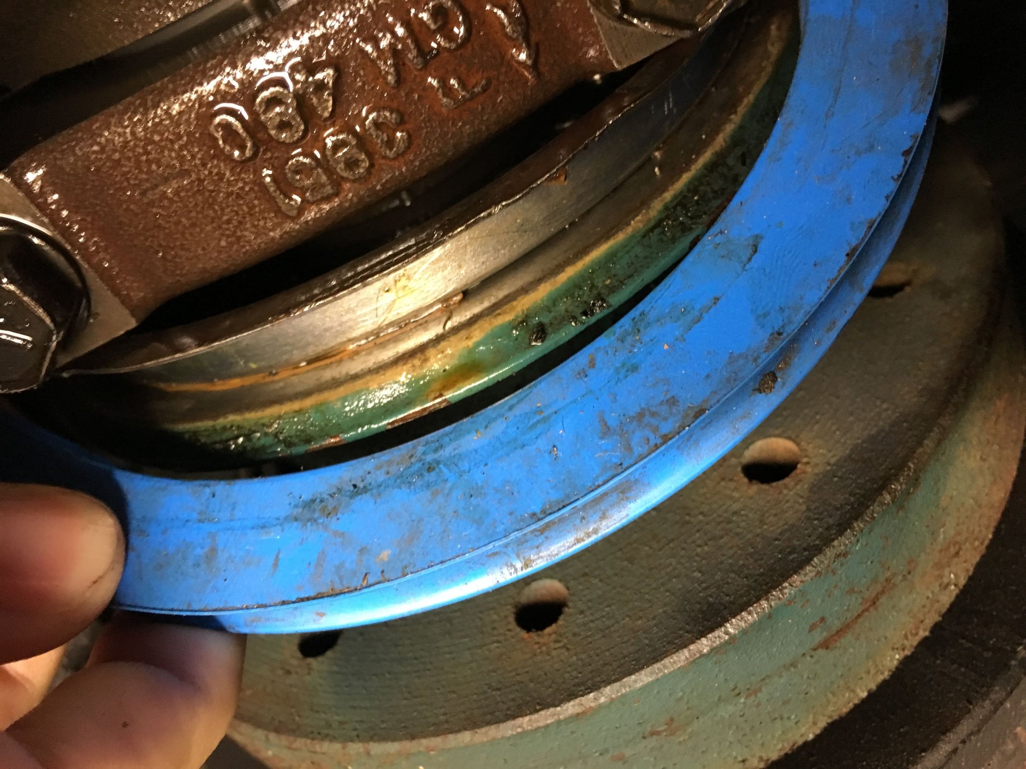

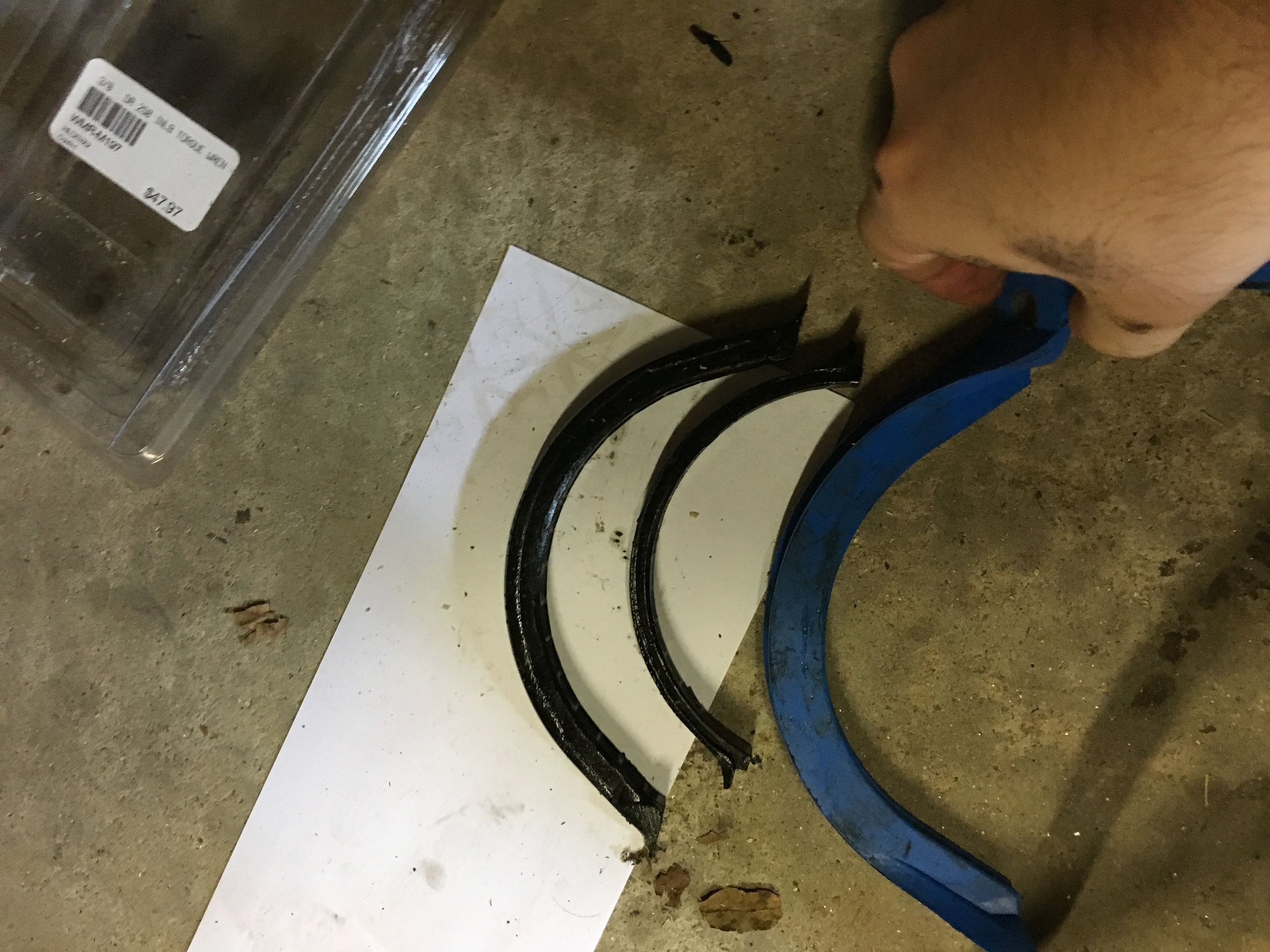

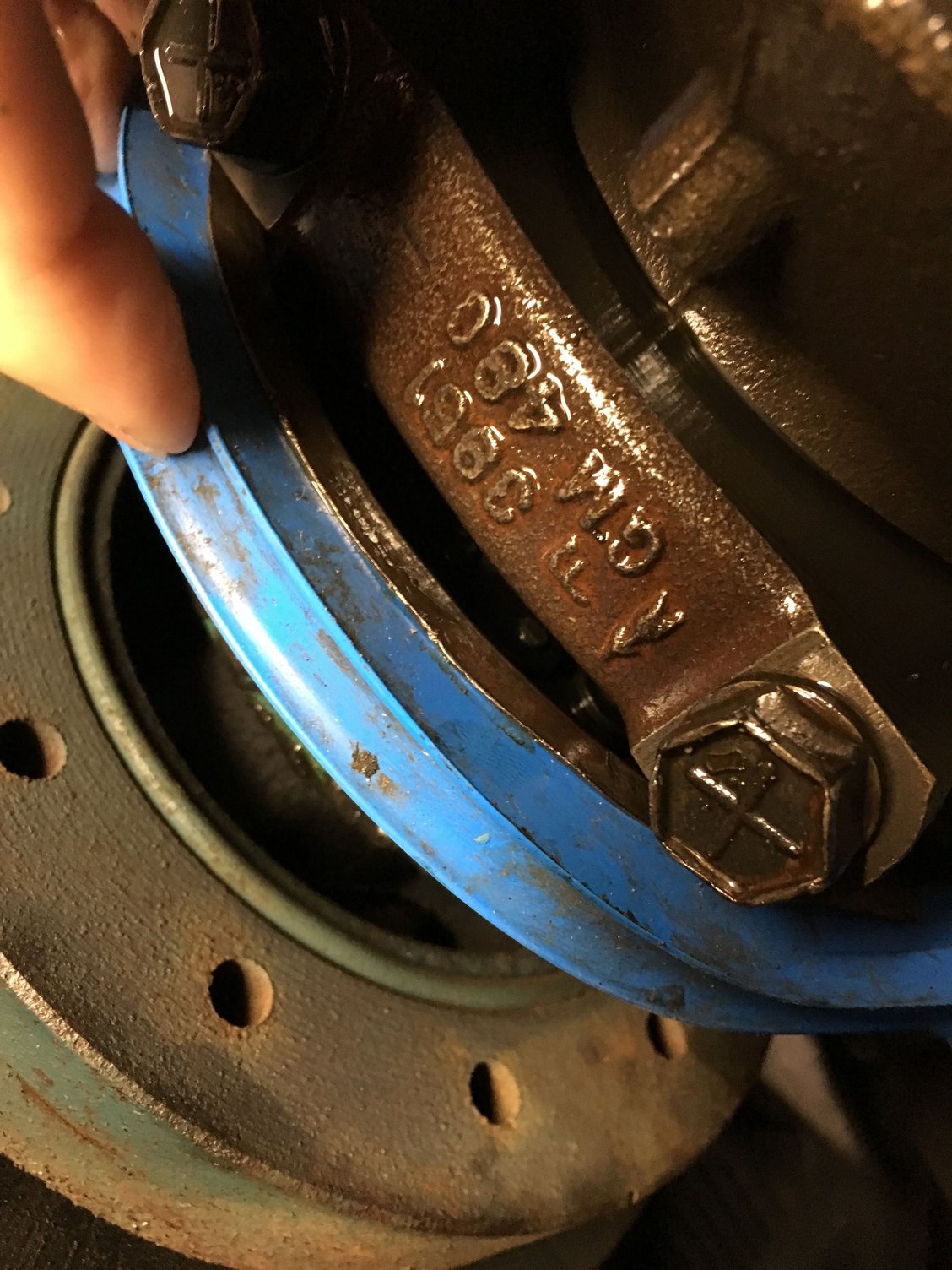

Old Aug 4, 2017 | 09:53 AM
tehjrow's Avatar
tehjrow
Joined: Jul 2017
Posts: 217
Likes: 21
Pics ( i know its all dirty, will clean before install )

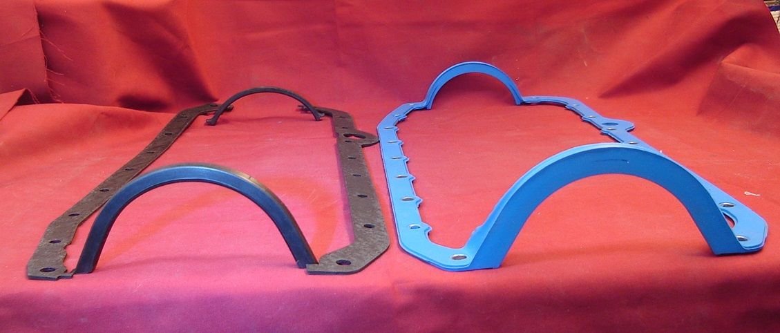

Old Aug 4, 2017 | 10:05 PM
TimAT's Avatar
TimAT
Joined: Oct 2006
Posts: 7,123
Likes: 433
From: Gladstone MO
That last picture is a great comparison between the thick and thin gaskets!!

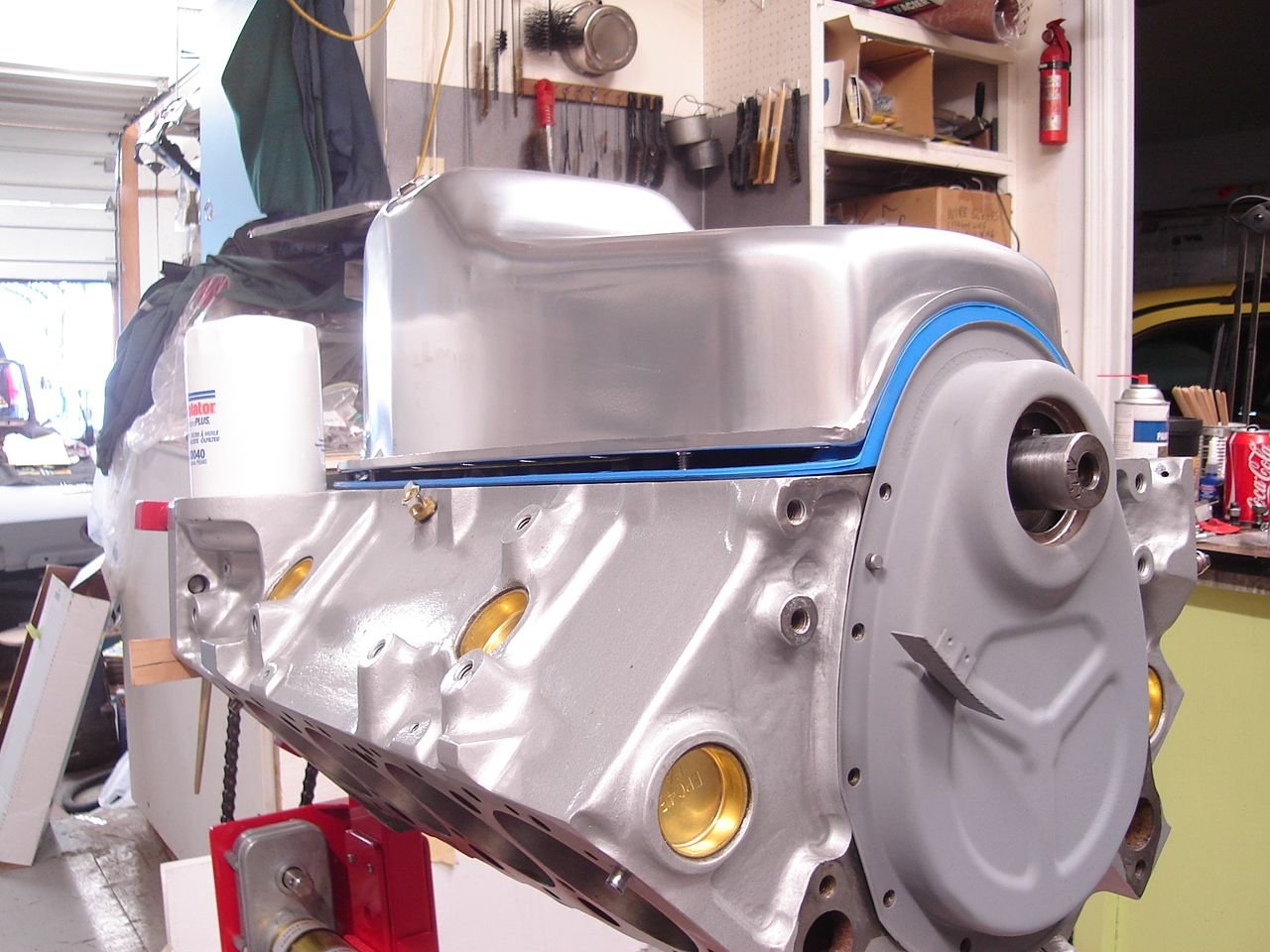

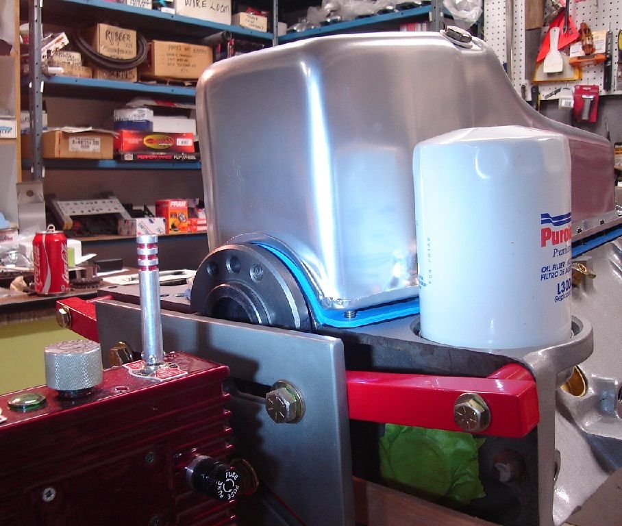

Does the front of the gasket compress that much? that is one huge gap at the sides of the oil pan?
Did the make a gasket that thick so that you don't have to put so much rtv on there?
Old Aug 5, 2017 | 08:03 AM
leadfoot4's Avatar
leadfoot4
Active Streak: 90 Days
Joined: May 2001
Posts: 87,357
Likes: 1,592
From: Western NY
Did they make a gasket that thick so that you don't have to put so much rtv on there?
NO.........they "made it that thick", because as mentioned several times in this thread, there are two different generations of that gasket, as designed by Chevrolet engineers.
