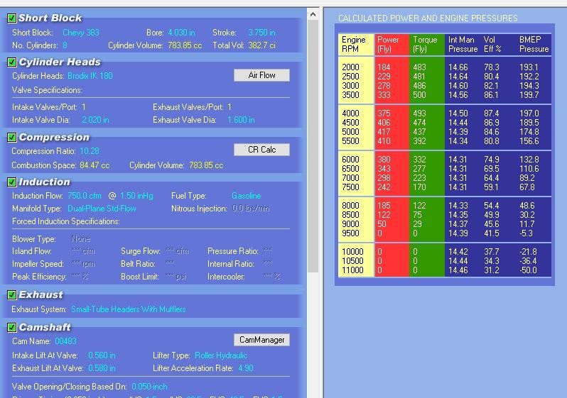

I was wondering, what is 1 dyno hp compared to real rear wheel hp?
I know there is different transmission, tyre and rear ends ec, but still is the a guide line, for "normal" street fighter cars?
P.s not my engine :- )

No, "PC dyno 2003" -v- real rear wheel hp

OK Let me gather my data and you can plug it in.

Hi,
I will try, can you tell me the manufactor part number for the cam and the heads?

Can you tell me the manufactor part number for the cam and heads?
op what are you trying to accomplish or plan?
th 15-25% comment is typical trans tires etc have an effect. Wouldnt base your build on a dyno simulator
I was just wondering.
I would never build a engine based on dyno simulator, never :- )
I was just thinking, what is real life, and what does the dyno simulator say.
