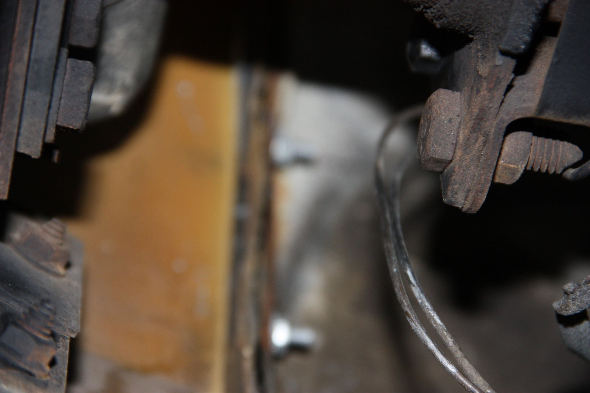

I bought new upper bumper retainers and restored the left and right side ones. Getting ready to put everything back together. I've had the bolts removed from the bumper gas shocks and the bolts going to the steel bumper that goes underneath the bumper cover for some time. I've derusted and painted everything and getting ready to put it all back together. In my haste I forgot to take pictures of the bolt orientation, the washers used, etc. For the bumper shocks the AIM seems to show bolts going from the rear towards the front with welded nuts on the frame and no washers installed. My frame does not have welded nuts. Do I use washers for these bolts? If I need to use the washers, do they go under the head of the bolt or on the nut side? The brackets that go on the bumper support have rubber pieces with studs and nuts. Do these studs get washers installed or just the nuts on the back?

teamo: The bolts for the bumper shocks that go to the frame, go in the two outside holes from the rear facing to the front, with just a nut. The other end of the bracket that bolts to the bumper support the bolts face the rear with washers under the bolt head, my bumper cover is back on so I can't see if there is welded nuts or not. Hopefully these images will attach and help.
Brian79
Mounting to frame
mounting to bumper brace
To rear bumper cover retainer
