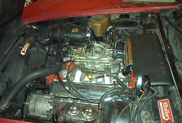

I have run the Holley 4175 650 CFM vacuum secondary Qjet replacement on my OEM L-82 4 speed since 1985 and still run the same carb on the rebuilt upgraded 355 L-82 with AFR 180 64 CC heads, roller cam, 10.2 compression etc today. Great carb! Easy to tune the primaries (currently running a 68 main jet up from the OEM 59), easy vacuum secondary spring kit for tuning the secondaries, easy to rebuild.....Ran better than the OEM Qjet on my 78 out of the box and continues to do so today. Only downside is the secondary metering plate, not jets.....Gas mileage is slightly less than the overly complicated Qjet...I mean slightly like 1 MPG......Holley are so popular because they are easy to tune, easy to rebuild, easy to adjust.
The problem with the overly complicated Qjet is that GM tried to avoid fuel injection, especially mechanical fuel injection, since they thought that the fuel could be precisely metered through a complicated carb mechanism like a quadrajet. They finally gave up after many years of trying to refine the Qjet to the level of mechanical fuel injection systems like the superb Bosch system used on may foreign cars. GM threw the towel in the early 80's with the crossfire being the final attempt at metering fuel through a carb throttle body...not a great idea or execution....There is a reason no one ever really was interested in cloning the Qjet after GM got out the Qjet business????!!!!!!!!!!
