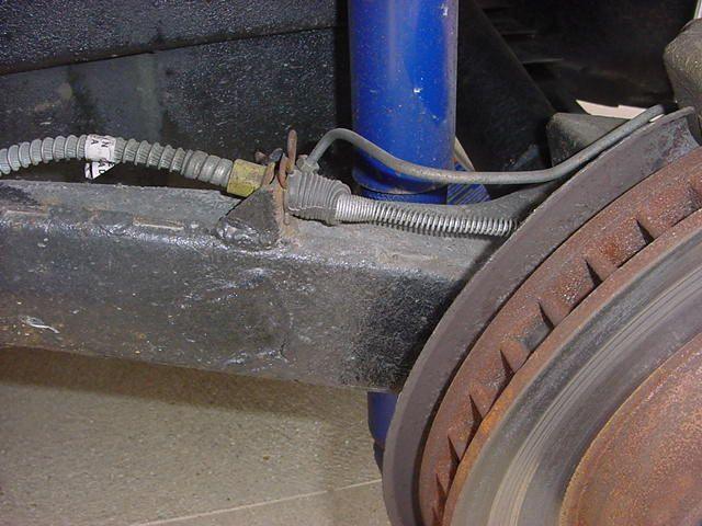

I'm using Global West rear trailing arms. I have to relocate the parking brake bracket to use wider tires.
Does anyone have pictures of where you relocated the brackets to?

This bracket?

No Pics, but i did the same as buns. Moving to the top was easiest within reach of the lines on the stock trailing arms.
