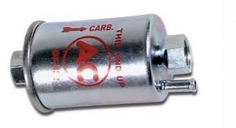

I wasn't aware there was a three port pump? Doesn't the 432 fuel filter (if I remember the part # correctly) simplify the OP's search by providing a return path with a conventional pump.

got one of these? The only need, so far as I know is to mitigate vapor lock
