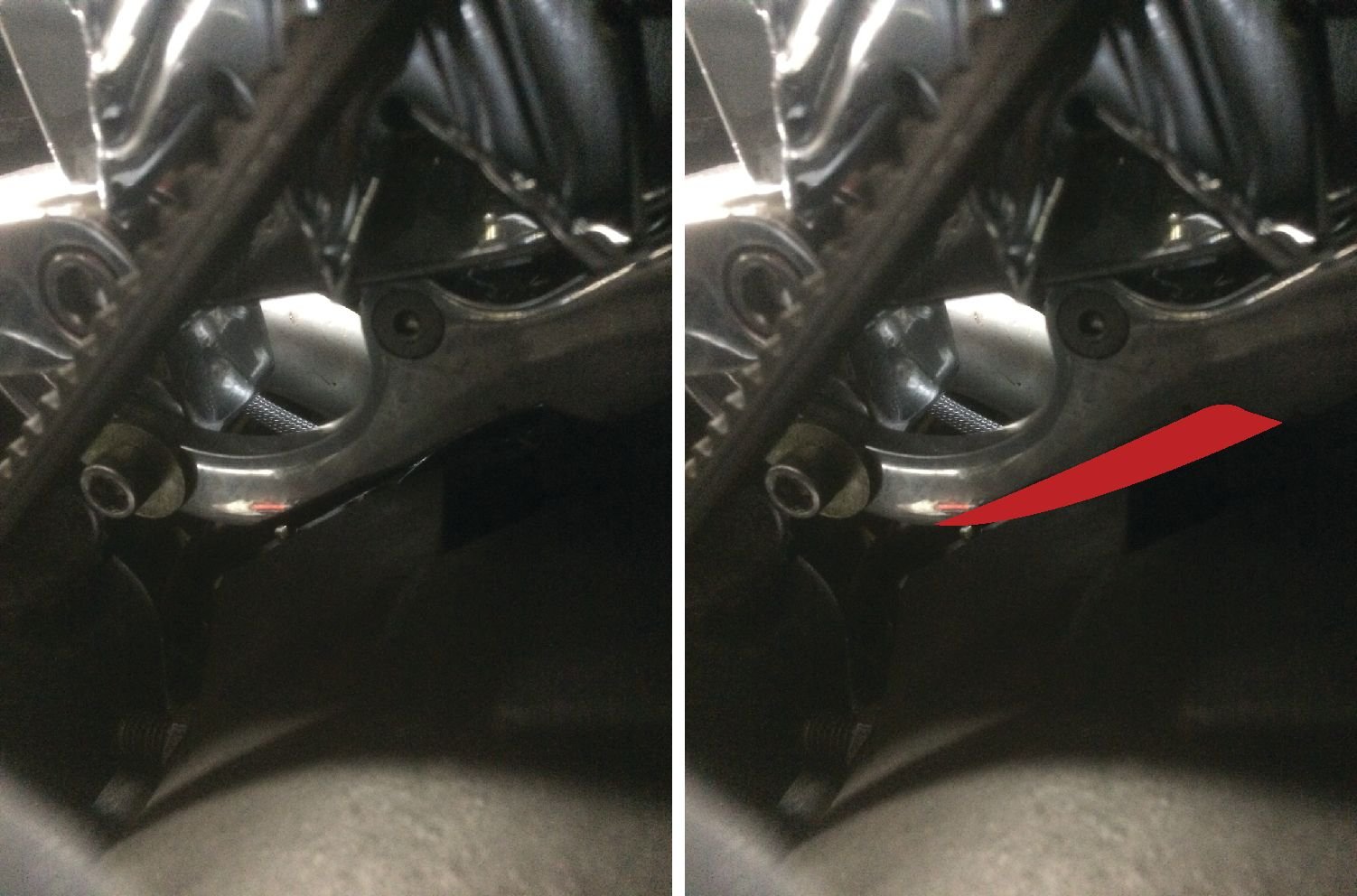

Red area is what I removed. I could almost fit my finger between top of arm and bottom of uncut bracket. I grinded a little over 1/4 off and it was still close but nothing touched after driving several trips over less than perfect roads

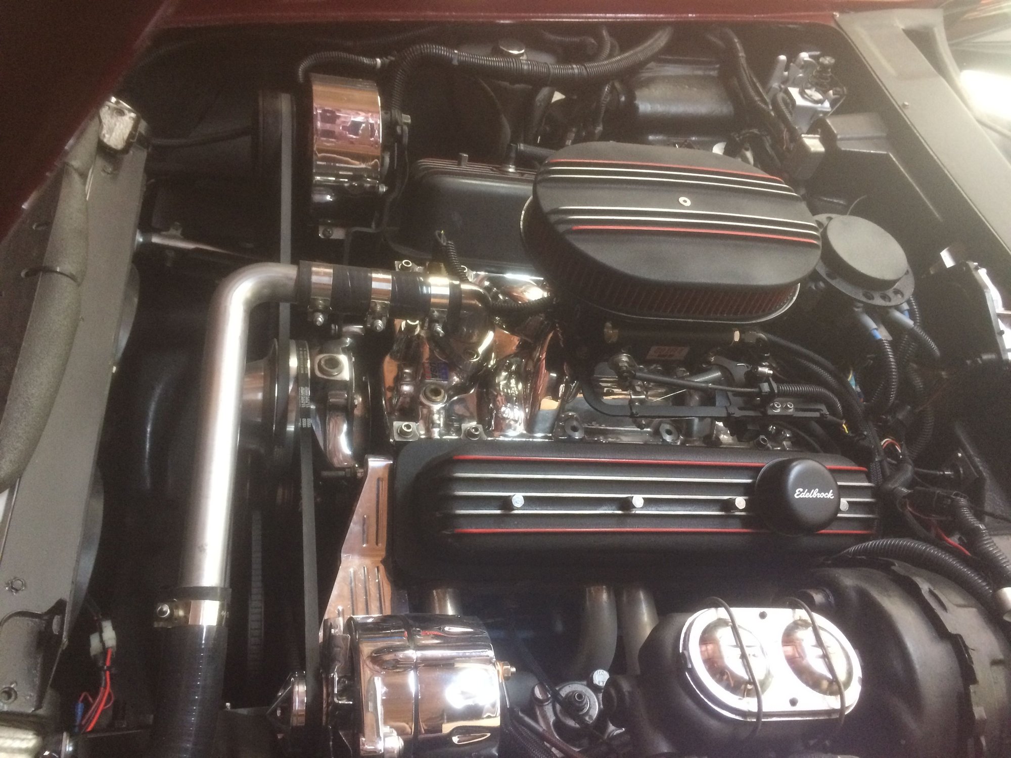

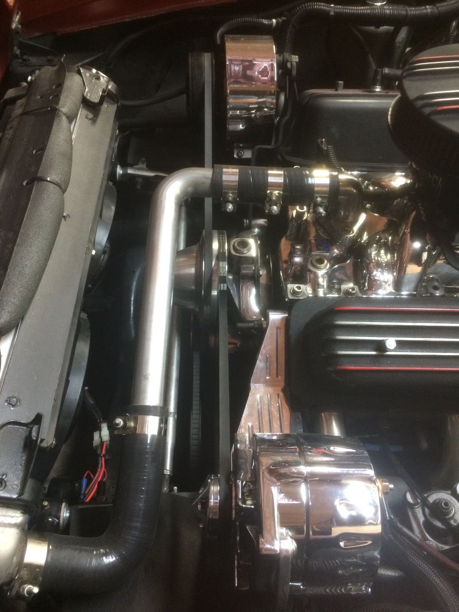

I sure like the looks of that billet one but I would question if it lines up with the crank pulley & W.P. pulley.
It fit mine perfect but its not a stock engine.

Looks real good Bloodzone. Lots of room at the valvecover too.

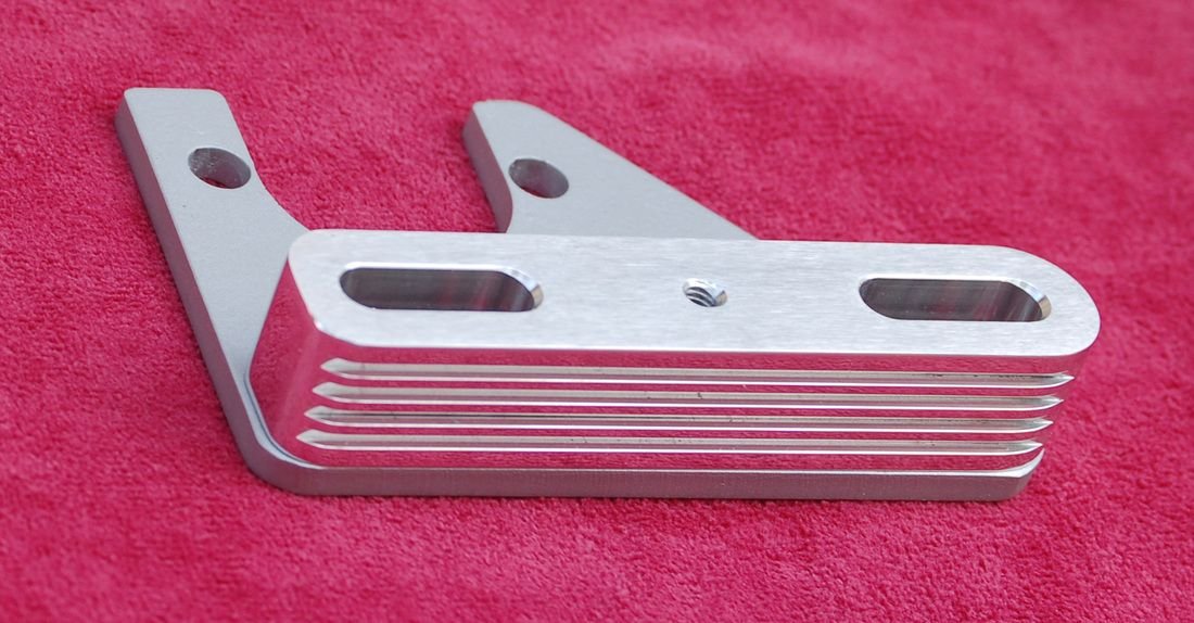

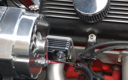

Do you run headers? You could use a polished aluminum Header Power Bracket. Will even work with tall valve covers, so long as they are stock width.
http://www.headerbracket.com/index.html
Lots of options too!
