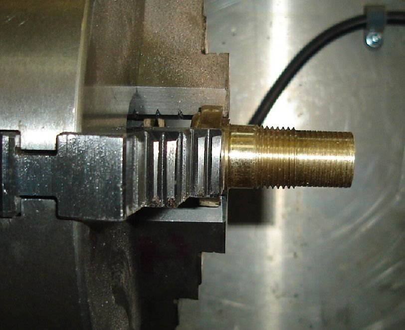

If your old sender is working properly, you could take it to a machine shop and have them turn it down and rethread with 3/8 pipe thread.
Here's how I did the sender from my '66. Took about 20 minutes.
...and that's what Wilcox is doing as well...
