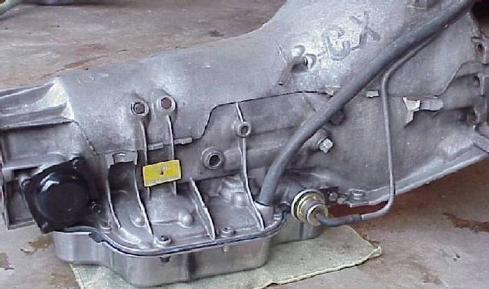

On a 1971 LS5 with automatic transmission, where would I locate Vin Id on that transmission and for a car built on June 25th, 1971 what would I expect to see?
Also where woulod be an easy location to see frame vin?

Transmission VIN is on drivers side.
Transmission tag is on passenger side.
Frame VIN is stamped just in front of the #4 body mount, drivers side.
