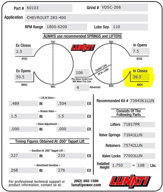

I'm a novice at this but I don't think your combo of head and cam works.
My reasoning is this. A good target dynamic compression ratio is 8.1 to 8.5. Your static compression ratio can be MUCH higher than this as long as your intake valves close sufficiently late to reduce the higher static compression ratio to a reasonable DR.
However, with your gear, I calculate:
Static compression ratio with relatively bad .06 quench = 10.58
.04 gasket, .02 deck height
5cc valve relief (SRP flat tops?)
64cc compression chamber
Dynamic ratio = 9.8
using Lunati 60103 with intake closing 39.5 ABDC
Assuming a better quench with a 0 decked block with .04 gasket, your SR raises to 11.1 and DR raises to 10.3:1.
As I mentioned, I'm a novice at this but this combo of small combustion chamber, early closing cam and bad quench looks like "boom" to me.
Dynamic ratio = 9.8
Yea, I forgot that my estimates were based upon the stock L82 block and a deck height of 0.025"; obviously if he goes with a 383 rotating assembly his CR will change depending upon the piston he goes with.
Good advice to figure out your static CR and ensure that your cam is big enough to keep your DCR in the safe zone:
I was using the Jeep calculator and using these values for my L82 stock bottom end and the Felpro thin gasket:

Even with a 10.26 SCR using a 350 that Lunati cam still doesn't work because the DCR would still be 9.5:1.
That cam needs a SCR of around 9.1:1 to end up with a DCR of 8.5. Or, to deal with the small combustion chamber you need a cam with IVC greater than around 63 degrees.
I think you're doing something wrong with your calculation for 3 reasons:
1. people run cams this small and even smaller with 350s with this type of static CR all the time; it has a larger intake duration than the stock L82 cam (227 vs the L82 cam's 222) with only a 0.5 point increase in static CR and the op is using aluminum vs. iron heads
2. I'm running a near identical cam intake duration @ 0.050" (228) with a nearly identical static CR and my DCR isn't anywhere near your # (although mines a fast acceleration roller cam so the advertised/seat-to-seat duration of my cam might be less than the Lunati cam)
3. I just calculated the DCR using the Jeep calculator and didn't end up with anywhere near a DCR of 9.5:1 (you're probably using the duration @ 0.050" instead of the advertised / seat-to-seat duration)
I just plugged all the #s into the Jeepsite as a 4.040" bore; the 40 thousandths over ups the static CR from 10.2 to 10.45 static CR and makes the dynamic compression ratio 8.39 and the quench 0.040" (about what it should be).
-Are you using the cam's duration @ 0.050" instead of the advertised duration?? (I just did that and I get a dynamic compression ratio of 9.5.) -Most of the DCR calculators require you to enter the ADVERTISED duration / seat-to-seat duration, not the 0.050" lift- the actual intake close event is only directly related to the seat-to-seat duration; not the 0.050" duration because the tool would have to make a guess about the velocity of the cam intake lobe ramp to estimate the intake close event, rather than actually calculate it.
DCR doesn't involve intake duration, only IVC degrees ABDC. No DCR calculator should be asking what the duration is. This cam has an IVC of 39.5. This early of an IVC means the DCR will be a very high percentage of the SCR. My take on this cam is that it was designed for a low compression engine with good emissions, low end torque and a wide power band.
However, maybe I am reading it wrong. Here is the cam spec sheet I used:
