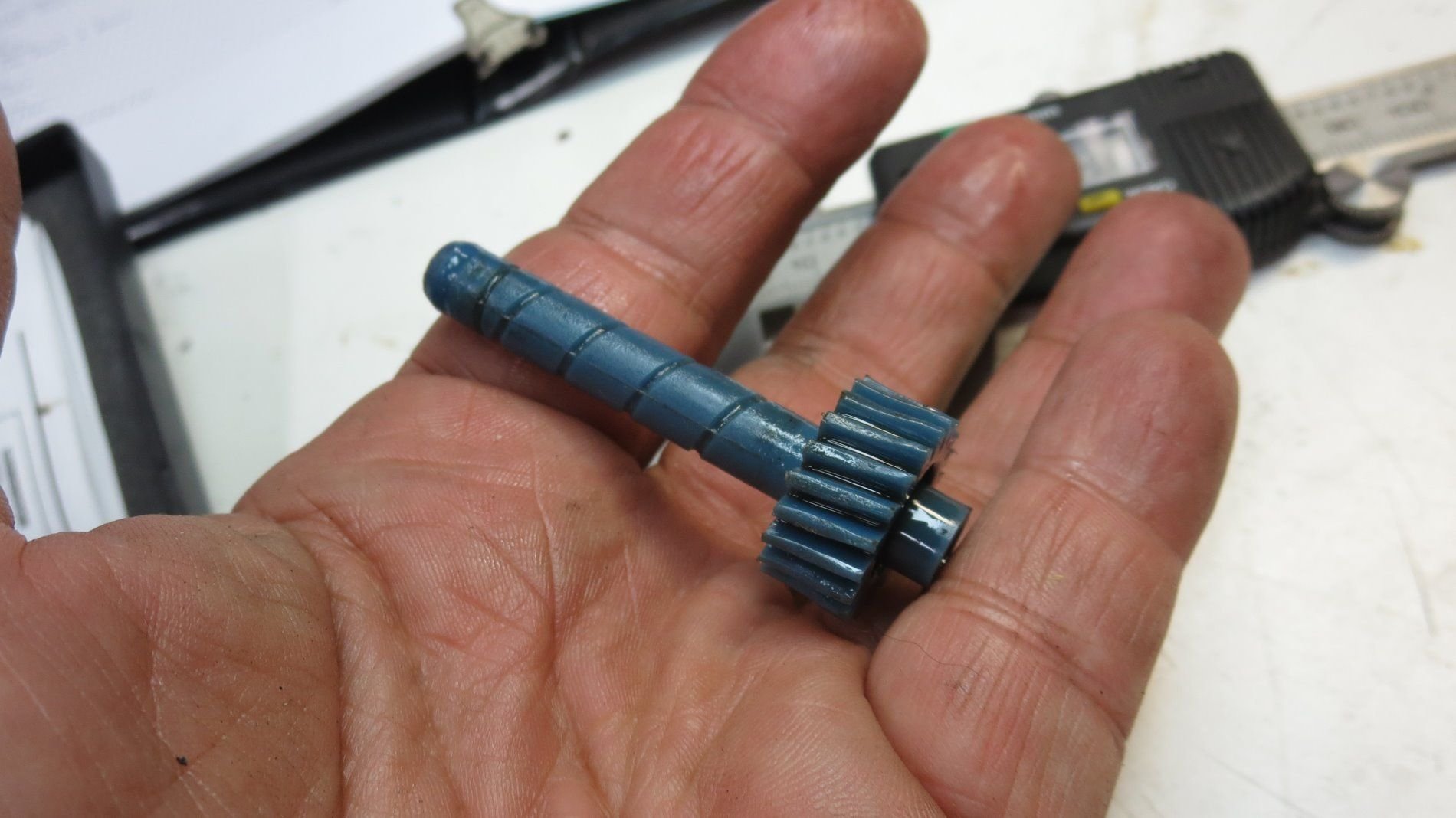

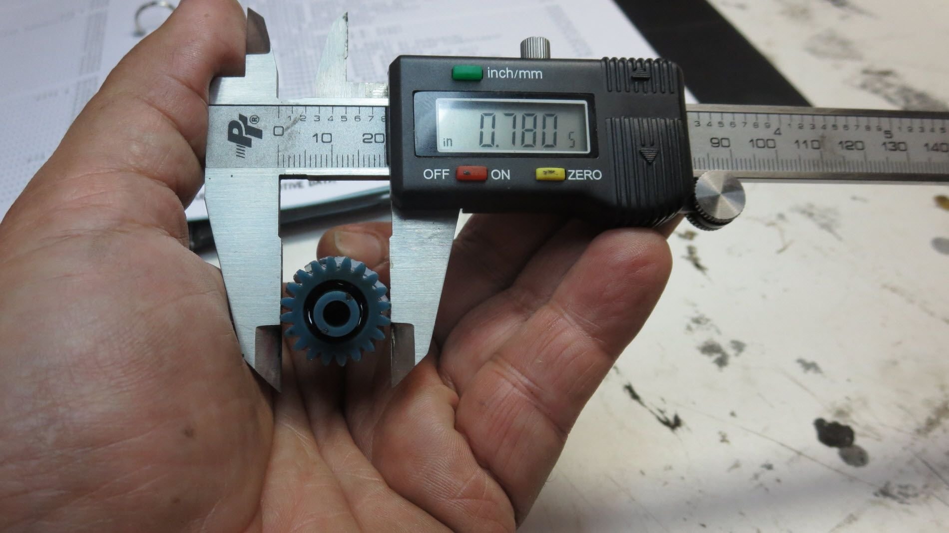

I pulled the cable from the tranny. It felt a bit loose as if it was not threaded completely. Nevertheless, I took it out and removed the sleeve assembly and the plastic driven gear. The gear seems to have wear. It is blue and has 20 teeth. The sleeve assembly has some buggered threads from the last time bubba was playing with it.... I hooked my drill to the speedo cable and the speedo works just fine. At full speed, reverse, it registered about 50MPH.
What is a good source for the sleeve assembly and driven gears? Zip did not have them and Eckler's seem to have a 19 tooth one..... appreciate the help!

I don't think that gear is your issue... In most cases the driven gear is not the issue even though it shows wear. While your old gear shows some wear, it's still meshed in the drive gear in the tranny.... If the driven gear was the issue you'd see teeth missing off the gear completely in most cases.
A bouncing needle is usually caused by a cable issue or a head issue in the speedometer.
So before I purchased any gears, I'd probably remove the cable and lubricate it first...
While the above bulletin from GM/Delco say's only use their lubricant, you can use any graphite style lubricant available from your local parts store.... just use it in the described method above. If you can't find it, I've got plenty of it in stock as well.
If the problem persist then I'd take a look at the speedo head. The head on the 1978-1982 speedometers is pretty resilient though with the only issue being the first worm bushing which is plastic and can be replaced pretty easily by a good shop. If you then need the gear, I've got them.. https://willcoxcorvette.com/corvette...oth-blue-56-81
