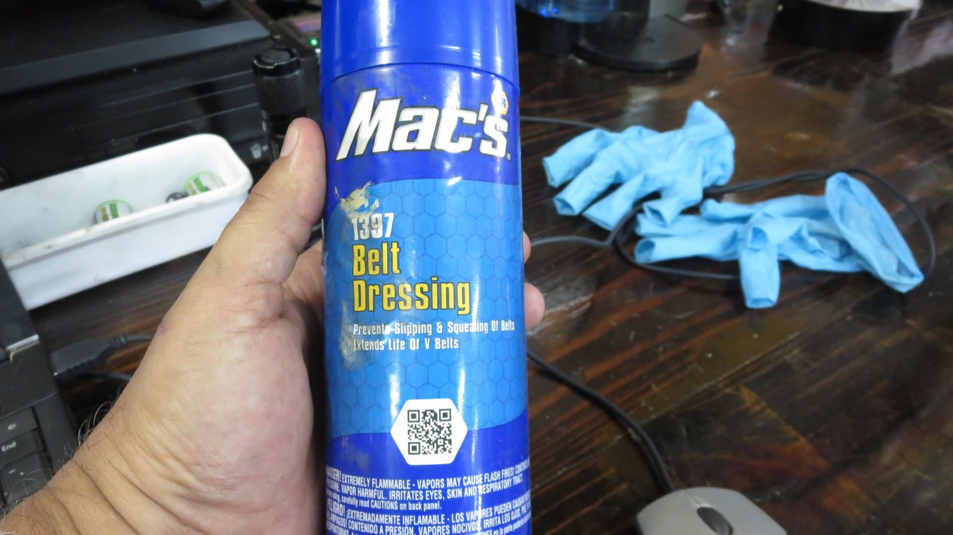

Use belt dressing as shown below. On my '77 Eldorado, once they went to 1 belt from 2 in driving that huge A6 A/C compressor, I could not get the squeal to go away with a new belt and proper tightening. This cured it.
However, the #1 cause of belt squealing, as mentioned by others, is a loose belt. Make sure that is not the issue first.
