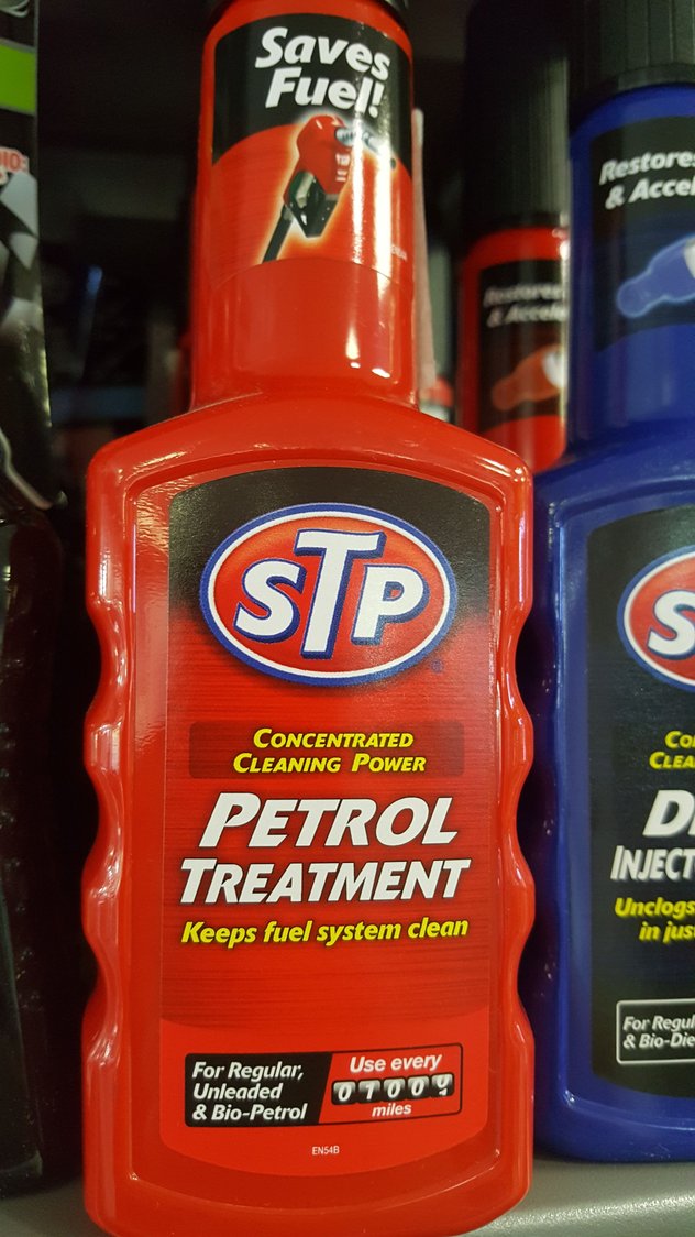

- Please your opinion about this type of treatment? (For my 1981 C3, 5.700cm, automatic)
- It helps?
- can he do something bad? Are there any negative aspects?
- not expensive
- I see this type of "cleaners" everytime in gas stations and i want to know if i make something good if i use it.
- Please detalied answer, i want to know if somebody use it and how much feel the changes.

I haven't used that kind of stuff in years. Your better off removing the carb and do a thorough cleaning by letting it sit in a solvent over night, blow out passages with compressed air and reassemble.

For carburetors, do what resdoggie says. For injectors, I just don't see how that snake oil diluted in a tankful of gasoline will "clean" fuel injectors. Again, I would remove them, inspect and clean them in an ultrasonic bath or similar method.

Use a Top Tier gasoline. Leave that stuff on the shelf.

A waste of money.

Fuel system cleaners can have some preventive value in vehicles with electronic fuel injection, but will probably have little value in a typical carbureted engine. If the octane rating is low or varies frequently, the use of an octane booster can be useful to prevent preignition in the engine.
