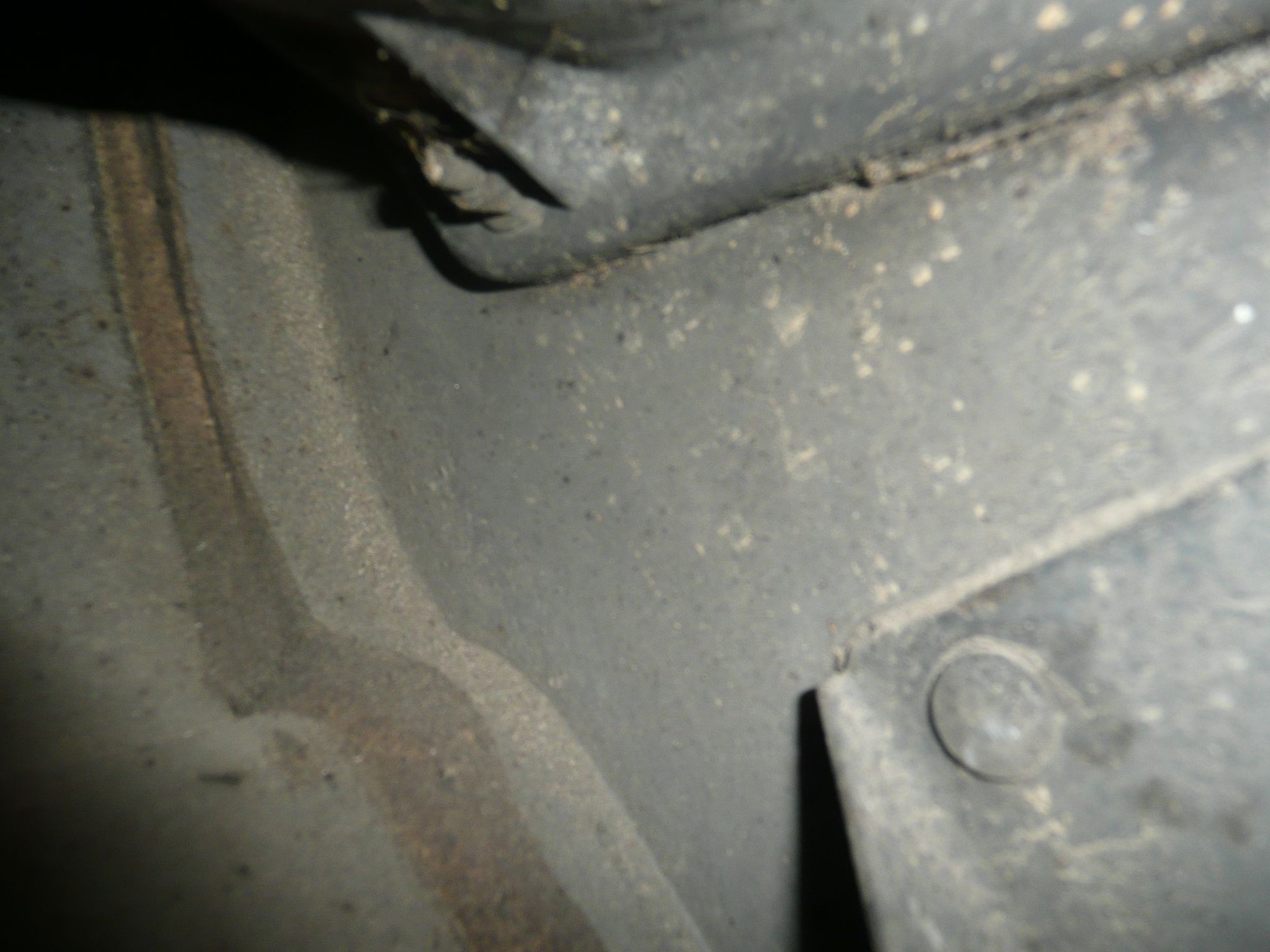

I was thinking of also replacing the heater core, I removed the bottom 2 nuts and I see one more nut at the top. From what I read, there should be one last nut in the engine compartment for the top, but I can't find it, anybody have a pic showing it ?

Here is the nut your looking for.

I'd replace the heater core since it's such a bitch to remove. Here's a picture of the nut you're looking for. It is under the fender. Tight quarters for sure. This pix is looking up from the bottom.
