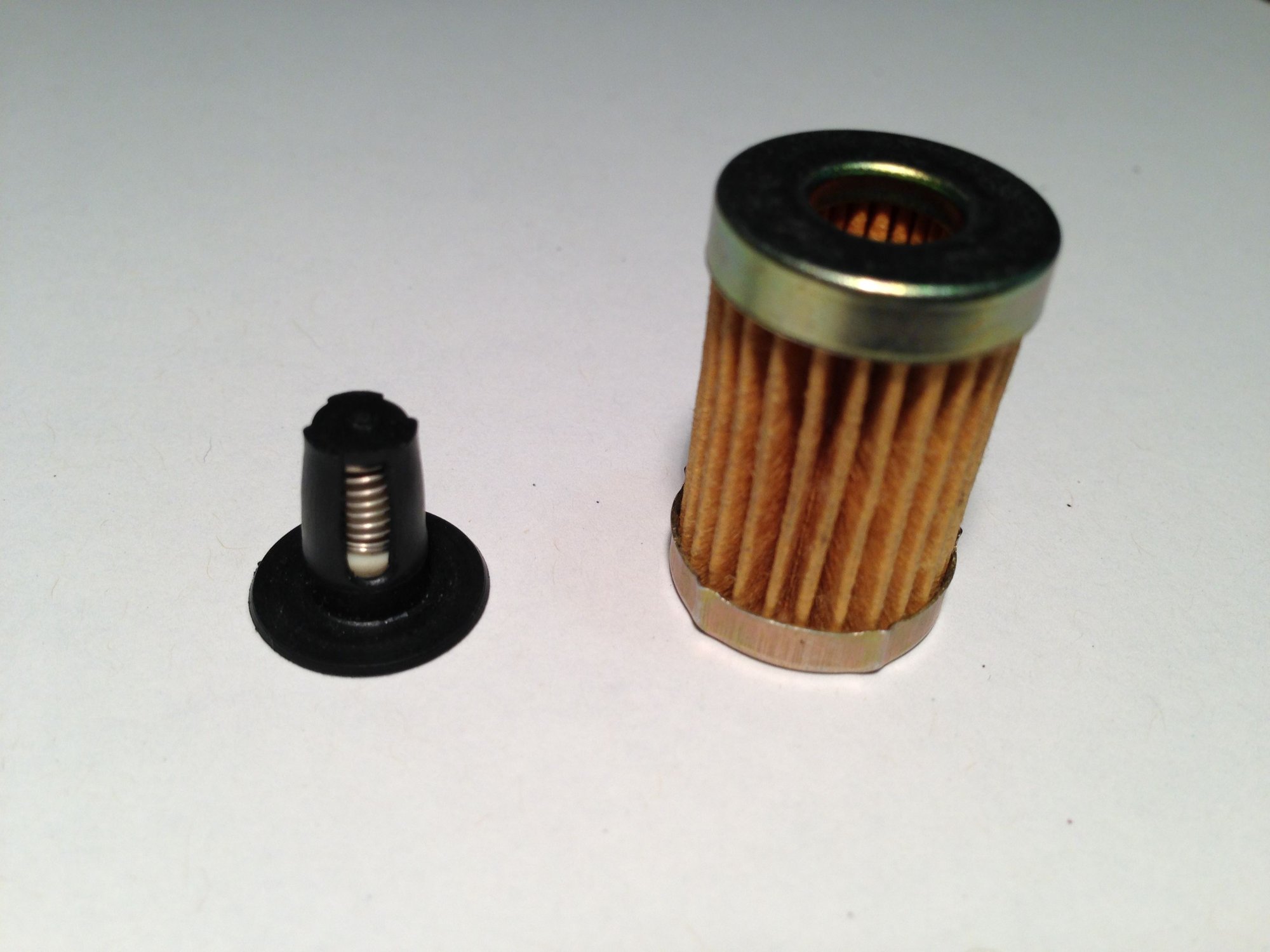

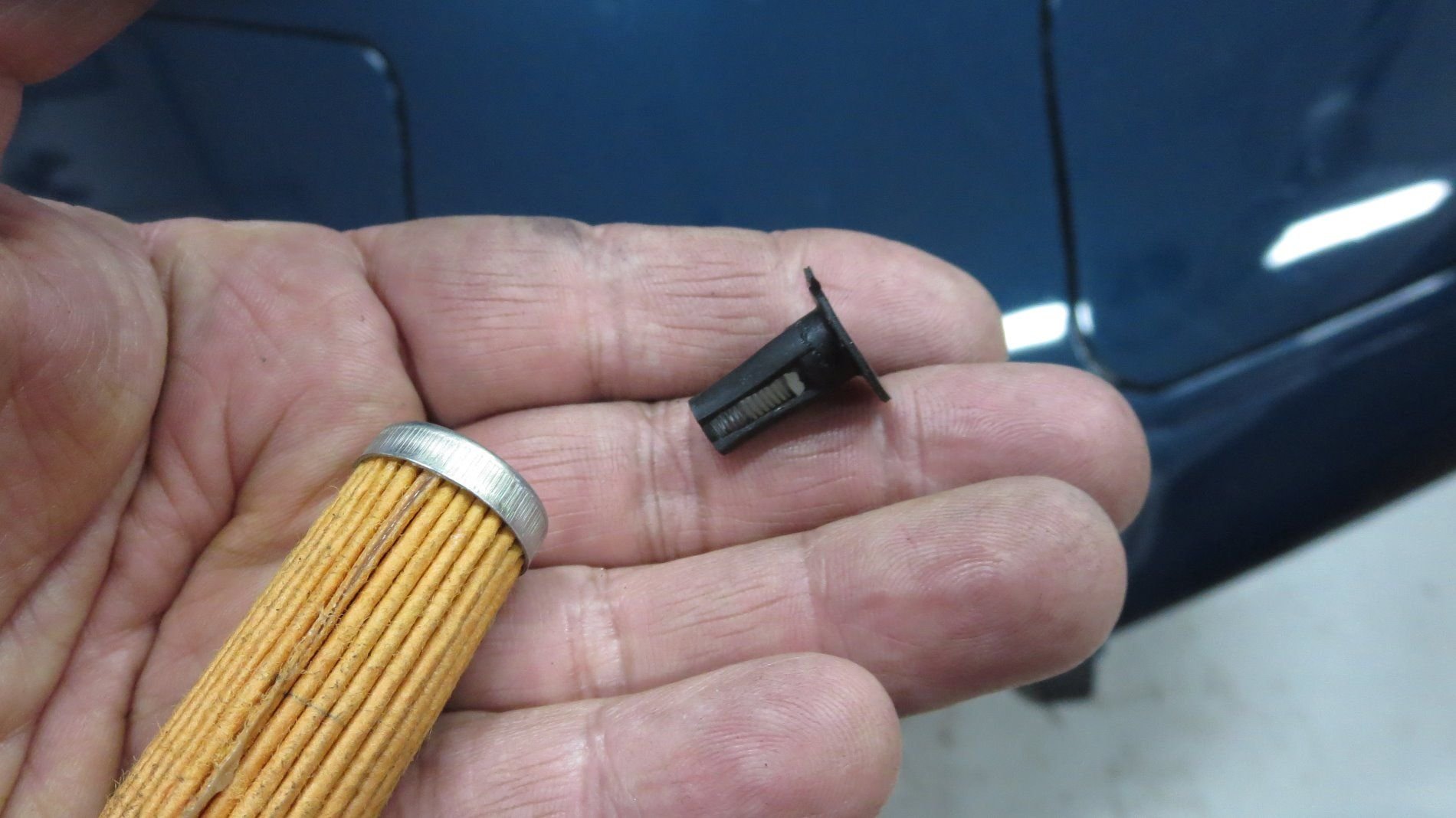

It is an anti drain back fuel filter that is sold mostly by Napa and they are garbage. It was designed to prevent fuel draining back out of the carb to reduce hard starts due to fuel loss from sitting overnight or longer. They sort of work but also cause an obstruction in fuel flow entering the carb and since they are spring loaded, also stick in the closed position due to shrinkage from poor materials. The ball inside ends up bigger than that outside black shroud and then it sticks in the spring loaded closed position.
I had one in my stock 69 427 and couldn't figure out why it was running out of gas at the top of second gear under hard acceleration and that was it. The filter had less than 200 miles on it and was clean so wasn't worn or plugged. I tried another new one with the same results. Then Lars mentioned the same problem with a caution about using them.
They are complete junk and although the idea was a good one, the design and materials used can leave you very frustrated not to mention the really lean condition when it runs out and dies at high rpm. They were never used by GM.
Below is a pic of the one I removed and you can see how the ball inside is bigger or pushing out against the walls on the black sleeve. That (along with the spring) is enough to drastically reduce fuel flow under high flow conditions like full throttle.
