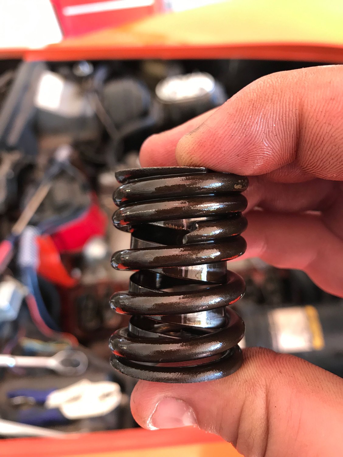

Man, you guys are good. I would say this would be my problem. Still figuring out stock valve seat pressure.

It's always best to replace all 16 of them because the other 15 have the same amount of miles on them.

Originally Posted by Tamaren
I don't, but I'm sure I can find one, or build one. I've never been this far into a Chevy, I come from the Mopar side of the world. Could I replace my bad spring and be on my way? Or should I do all 16? Or pull head and make sure I still have something resembling a valve seat? Heads are bone stock L82's.
Sounds like a frame-off in the making....

Just got back into town and was able to do more than start up and idle.
Still pops through exhaust something terrible under acceleration. Seems to be when engine is under load. Idle is much better. Still only passenger side. Throttle response much better.
Vacuum is much better, but has a 2hg rapid fluctuation (down from the 10-12 hg rapid flux.)
Have strong 150 psi of compression on all 4 of that side.
My thoughts:
1. Could need to reset valve lash
2. mixture? Seems to run/idle okay, just pops through exhaust under load)
3. Timing (Set at 37@2800 total)
I could possibly upload a video to explain my problem more clearly.

Originally Posted by JoeMinnesota
Did you lay a straight edge across the valve tips after you fixed the springs? Bent valve(s)?
I did not, I just replaced the one valve spring. If it's not something I'm missing I will do the full 16. Valve in question (the one with the spring I replaced) was not bent.
Had good compression, couldn't fathom a bent valve would yield me decent compression...
Plugs and plug wires are brand new.
