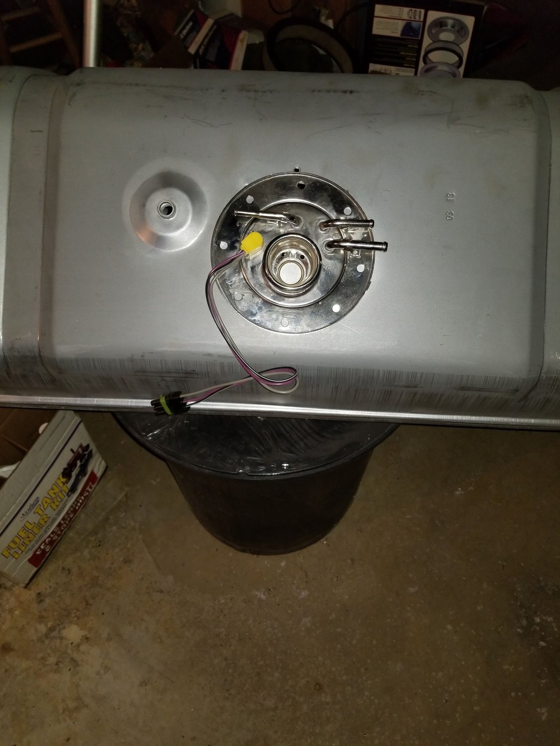

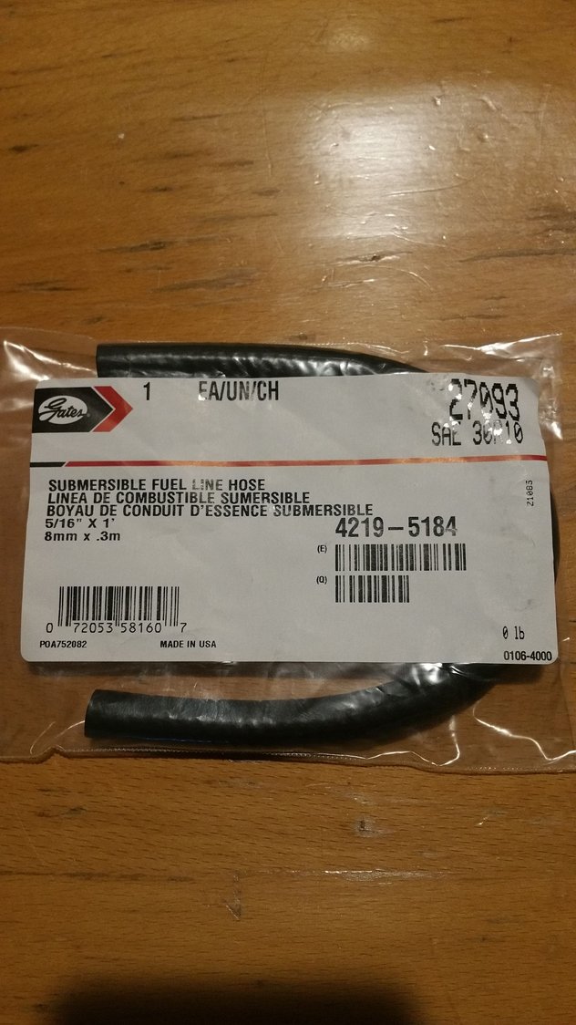

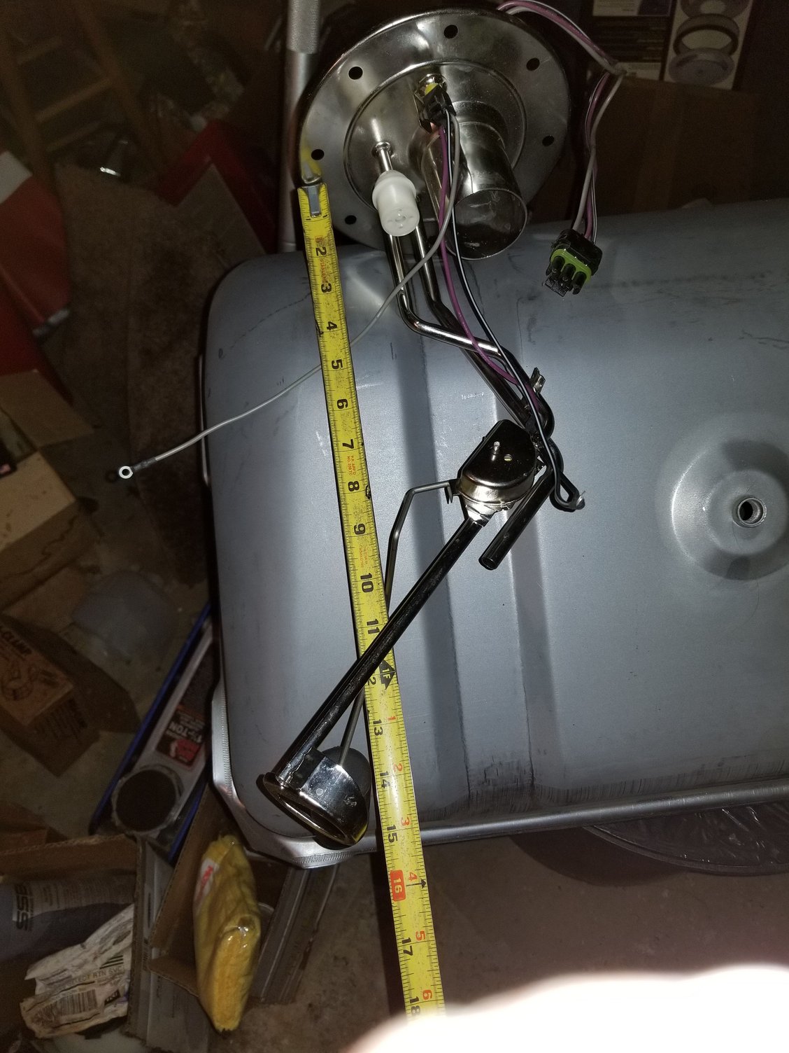

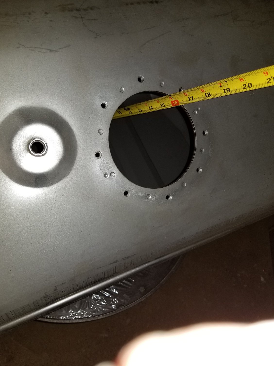

Got some pics. Don't know if they help much. The fuel pipe is 3/8 and return is 5/16 Be aware that the return line is also the pump mount
and terminates at the bottom next to the bottom of the pump. Could cause a problem with Holley mat. Maybe a diffuser of some sort to spread out the flow? Also, the whole thing angles into the tank so the pick-up is forward of the mounting hole. The end of the pump (I'm using a Walbro GCA758-2) hooks right to the filter sock so there is not a lot of room between pump and tank. Looks like 16-111 has the right connector for the pump.(758) Don't know about any other pump.
Hope this helps a little. When you get it figured out then you can help me.
