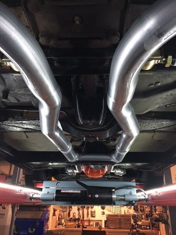

I installed Doug's D350 headers and absolutely love them. This is after I ordered (not the cheapest) pairs from Hooker and Hedman, only to return 2 sets when they showed up with rust between the primaries and in one case dings and scrapes under the ceramic coating. What a pain. I finally opened the wallet and bought a set of Doug's and they are excellent. Excellent fit, great plug boot and wire clearance, great clearance around my clutch linkages, and the collectors were tucked up pretty tight (aimed at the inside corners of the tunnel where firewall and floorpans meet). I put on temporary turn-downs to get it to a shop and they bent 2-1/2" all the way back. He fabricated 2 "s-pipes" from the collectors to main pipes. I had a 1-1/2" H-pipe installed behind the trans crossmember to kill some drone, as I am running louder Flowmaster 40's. The crossmember is an issue if you want to pull the driveshaft, but in my case I'm doing the back 1/2 right now and diff is out so I could drag it out the back.
No clearance issues, nothing low to the ground, no dragging flanges.

Looks great! I like the way they clear the starter and oil filter.
