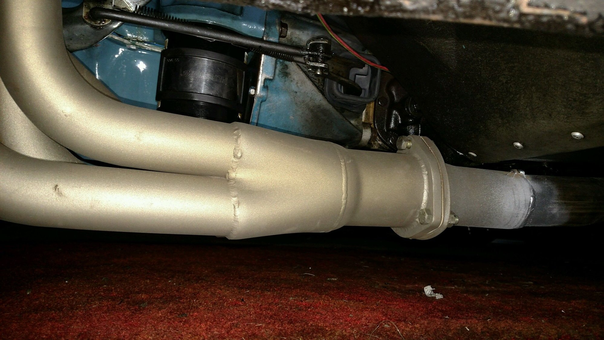

My Stainless Steel Headers ceramic coated locally. I have no heat issues with these headers coated...no heat in the car, under my feet or emanating from under the car when standing outside with the car running.

You might want to get a wrench on that top bolt.

Looks a lot like VHT coating because of the overspray on the extension and the matt finish as opposed to a luster. And you might want to get a wrench on that top bolt.
The coating is definitely ceramic, trust me, it has a textured finish (almost a rough feel) and is thick, not like paint. It was baked in a oven for final curing and definitely reduced the heat from the header a LOT. The overspray was from the muffler shop on the weld connecting the header reducer to the 2.5 inch pipe. And yes, that bolt was left loose by the muffler shop and was corrected by me.
