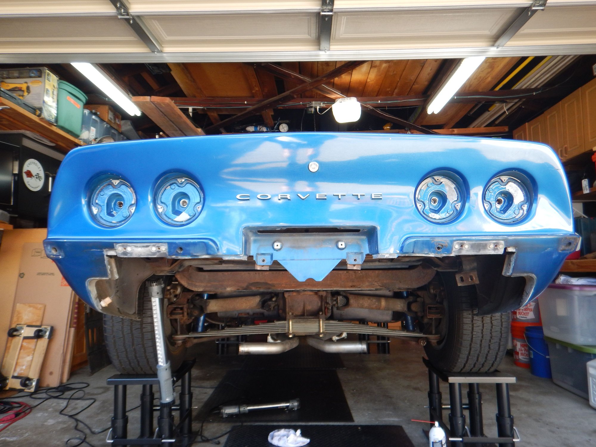

Just a suggestion, but instead of investing in parts now, invest in safety first. I'm not a fan of jack stands or blocks but I found some very safe useful stands that allowed me a comfortable working space. Good luck.
Myliftstand.com<br/><br/>Worth every penny IMO
But had I known of the Ranger Quick Jack I probably would have chosen that.
