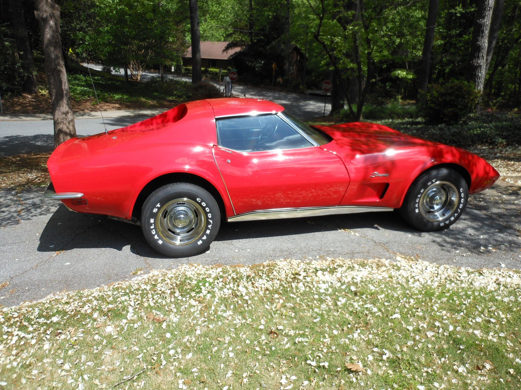

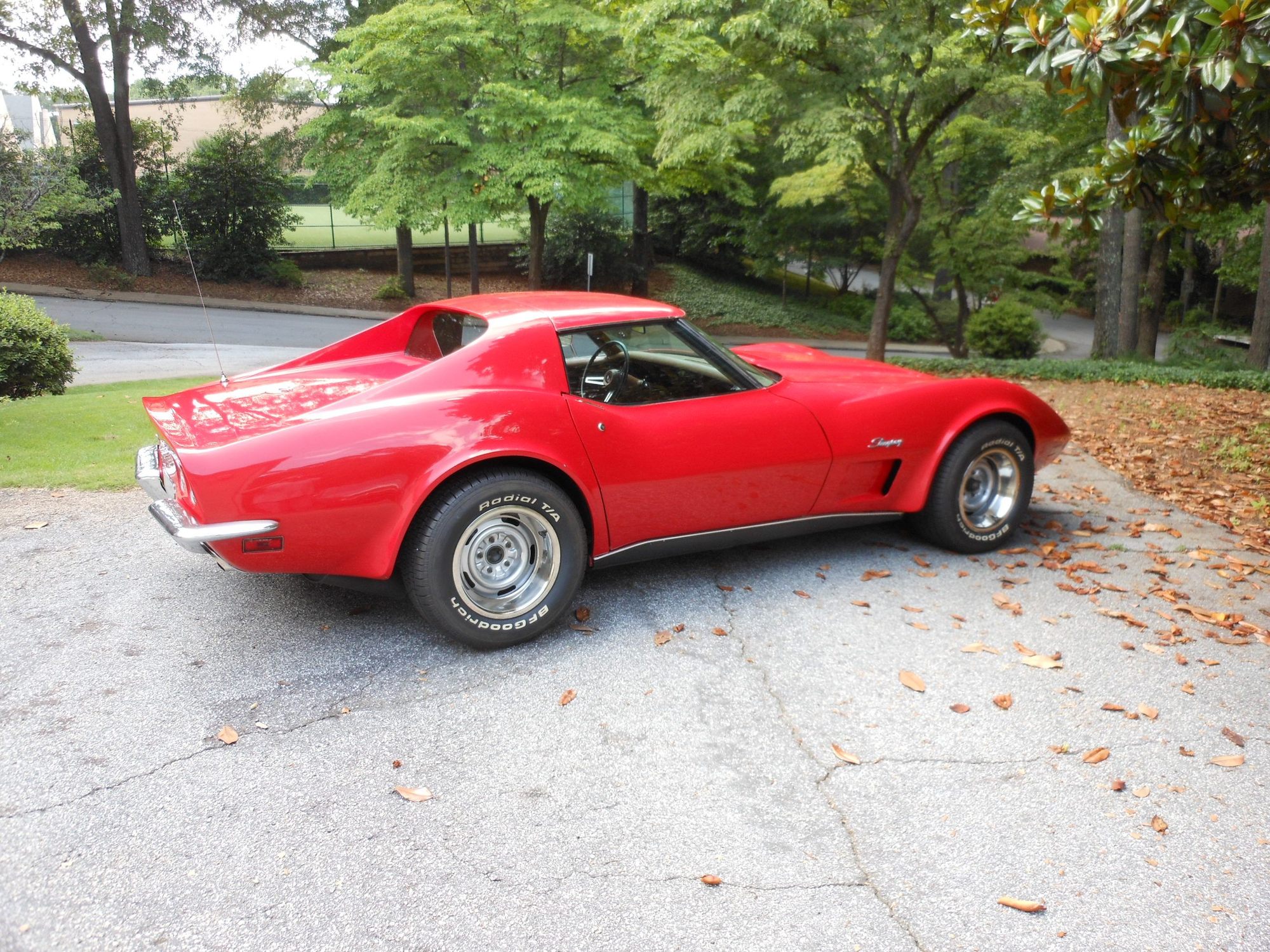

The only issue that I see-
The fiberglass spring getting too close to the exhaust.
There are heat shields out there-so do look at adding those if you go that route.
I used longer bolts for a C4.
Richard
Before-
After

Thanks guys. Good info so far. Richard454, I have the C4 bolts already but haven't installed them yet. I'm wondering if I will need to go even lower. Thus this question. How much drop in inches did you get from the bolts? (Inches)
In my case around 1-1/4"
