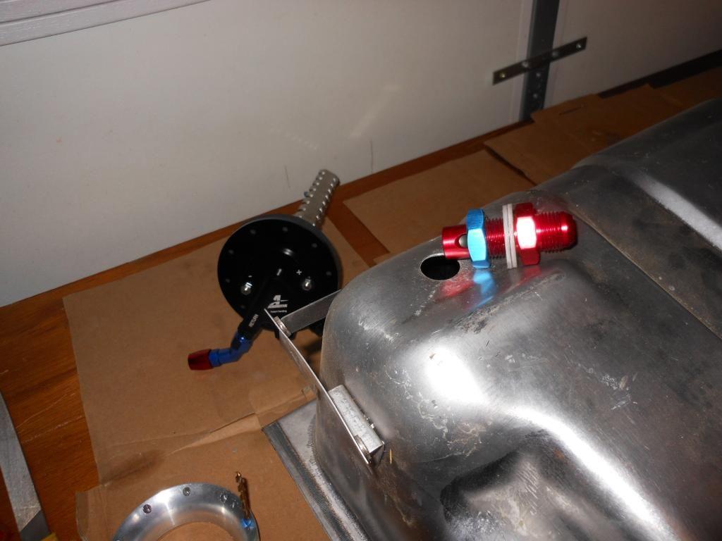

Doing a E85 conversion and there will be quite big electric fuel pump (MagnaFuel ProStar 500 Fuel Pumps with Filters MP-4450) and it (SBC) should produce +1000hp with NOS. I may do a little bit drag racing in future with it so I try to follow 9 second car rules by NHRA (actually by FHRA which is our local organization).
The original tank is now on the floor und I was wondering if I drill a hole for ventilation as well. The original Gas Cap is vented but I'm concerned if it flows enough air via cap and also what if I roll over the car.
So what have you put in your car/tank in similar situation? I noticed that Ecklers has a sending unit which is built to E85 specs. My old sending unit is broken so I probably buy one. Only I need to block the gas pipe since I will have larger AN fittings.
I'm planning to have a real race tank after a year or two and would be really happy if I can utilize the old tank for now.
22m hole for return line fitting
22m hole for fitting to pump/filter.
