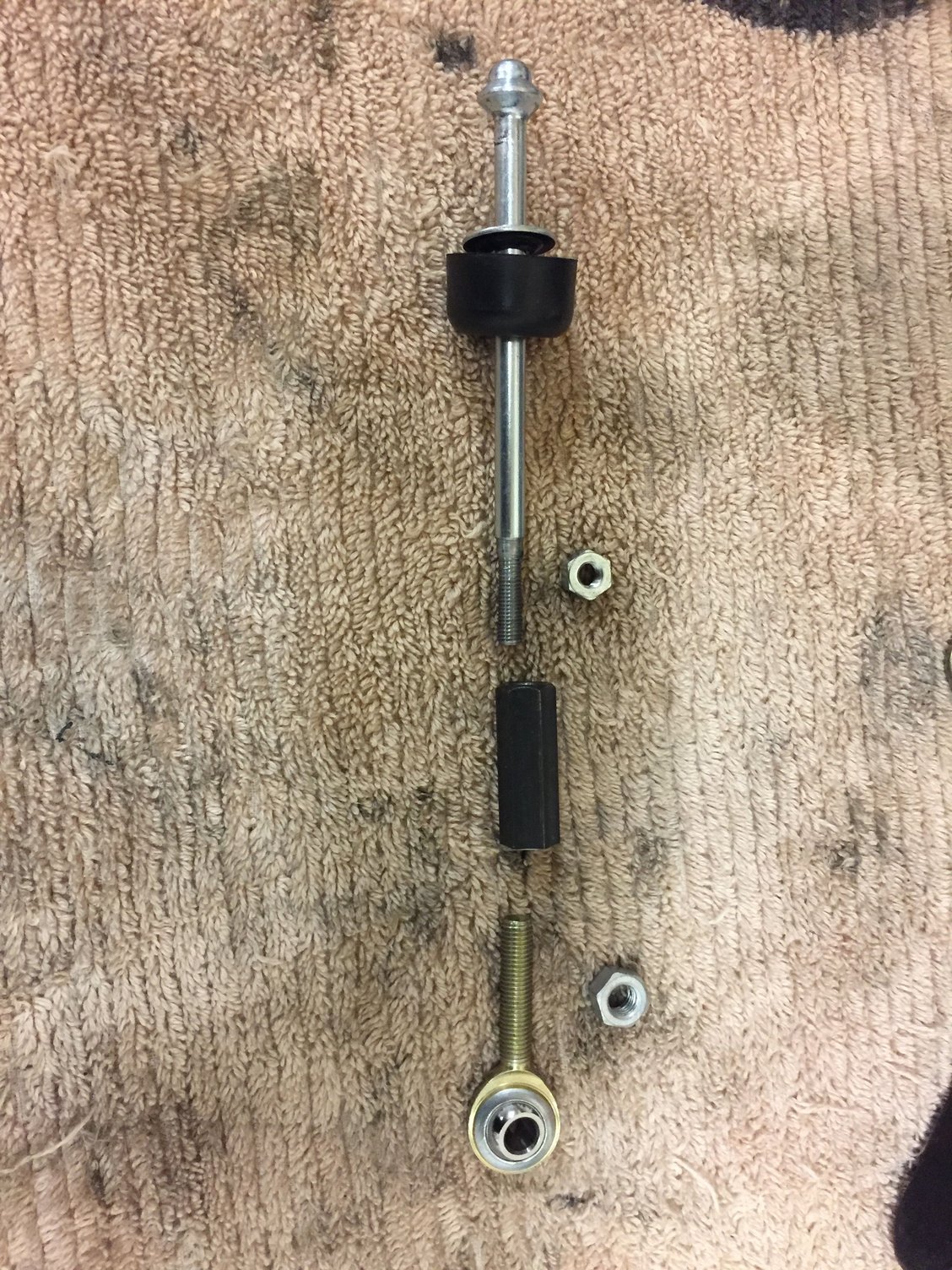

The adapter is the connector...along with a jam nut on either end. The joint has 5/16-24 external threads on it, there are internal threads available but the rod is only .280 diameter, not enough for fine 5/16 threads......that would be too easy hahaha so I will turn the rod end down to .25 and use 1/4 threads and make the connector to match

The rod will take a 5/16 die alright...maybe I've been in the machining business too long, but I would prefer full thread engagement

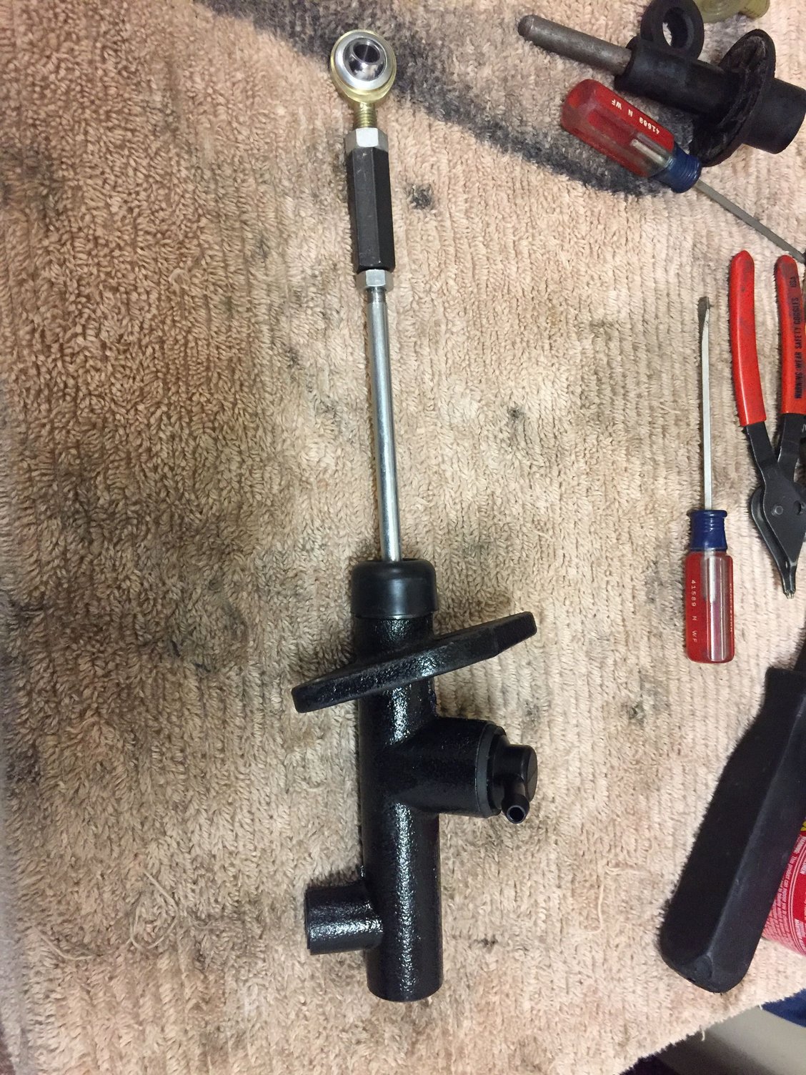

Was able to get into a lathe today and machine the end of the clutch rod, also made a connector.....I have the clutch cylinder assembled and forgot to tak a pic of it before turning in for the evening, will do that tomorrow and hopefully have it installed

Ok it only took a second to run out and snap a pic

Nice

Thanks, looks a lot like yours lol
I should have it installed tomorrow evening, then I can move on to the next job
I really should start a thread for the trans swap now that the clutch cylinder is about done
