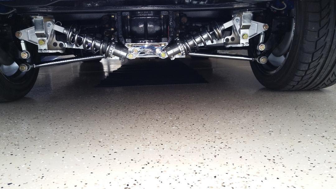

Also post a picture of what it looks like now. Maybe it is correct.
Here is mine.
Old Feb 8, 2018 | 01:12 PM
ddawson's Avatar
ddawson
Posts: 5,738
Likes: 644
From: Lincoln, CA
Here is a closer picture.
I see you have them adjusted pretty tight. Why not loosen off the spring and see if it improves or have you done that already
Old Feb 8, 2018 | 02:38 PM
ddawson's Avatar
ddawson
Posts: 5,738
Likes: 644
From: Lincoln, CA
This is my car not the OP. What you see though is how you adjust ride height not spring rate.

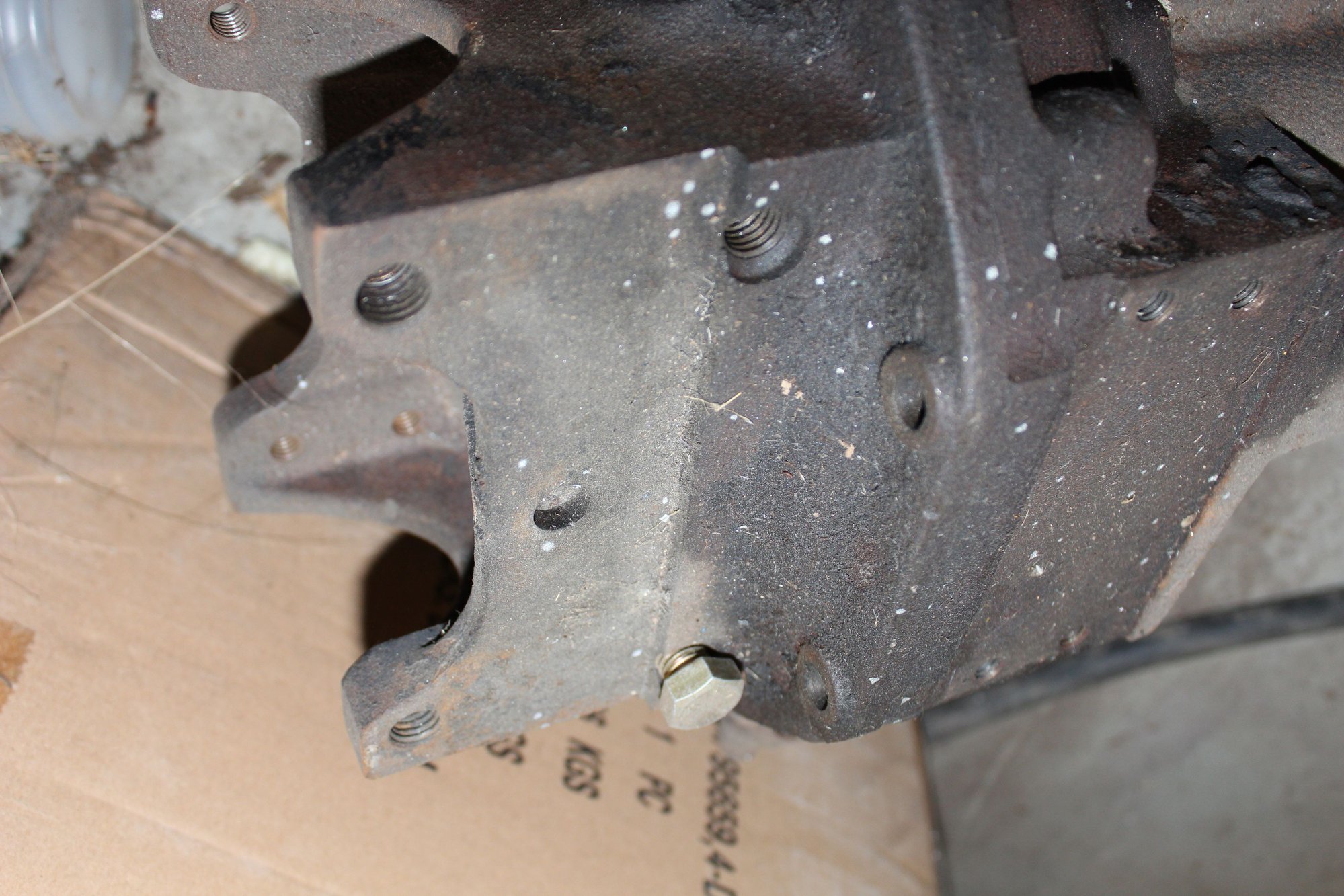

I have the 71 up on the hoist. I do not know how to put pics on here sorry. I shorting the eye bolts up, but the center bracket that says (shark bite) on it does not set flat on the back cover of the rear end. did they install the cover upside down or can it be the wrong cover or it could be the wrong bracket
Old Apr 25, 2018 | 04:35 PM
Speed Direct's Avatar
Speed Direct
Premium Supporting Vendor
Joined: Nov 2002
Posts: 1,485
Likes: 81
From: Santo TX
There are two styles of Diff covers and two corresponding center bracket designs. The 63-77 cover (which yours should be) has the flat cut for the spring mount just behind the two bolts closest to the axles. See the photo.

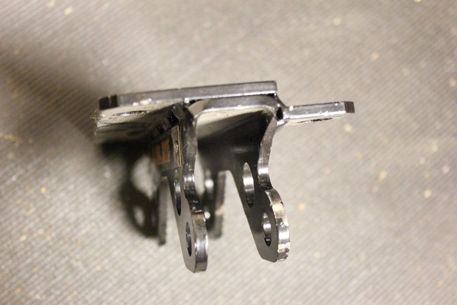

Our bracket has a step to accommodate that cut.
Sharkbite shock mount bracket 63-77
The 78-79 diff cover requires a flat bracket with no step. It's possible that either the wrong bracket was ordered or the diff cover was changed at some point in the car's life. 63-77 covers use 9/16 bolts (13/16" hex head) were 78-79 covers use 7/16 bolts to secure that center bracket.

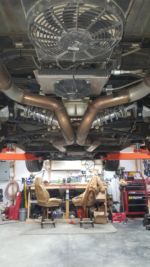

Here's my setup. I went with the 450 springs and double adjustables.
It rode like a dumptruck.
I installed 350 lb springs. Ride is superb now. Height adjustment piece of cake, and having adjustability on both compression and rebound gives me plenty if adjustability for both street and track.
