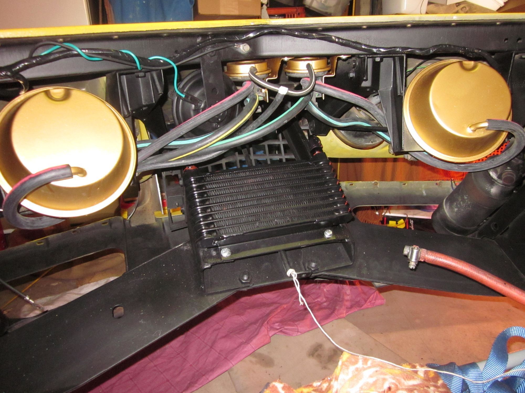

here's where i mounted mine in my '72
doesn't interfere with the radiator, have added a couple of extra deflectors top n bottom to direct air thru it more.
have just recently replaced it with a taller one, had trans failure and was easier than cleaning the orig one out.
